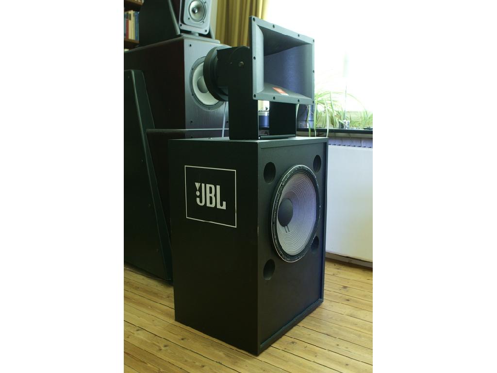

    As I am planning to create a large 2-way (JBL Screen Array-like) system. The picture shows the JBL 4673, which concept I like, but I intend to better its looks and hopefully its sound.

    The cabs I'll be using are professionally made (baltic birch on the inside and thick MDF panels on the outside) and quite big (192 Liters = 6.8 cu ft, 15 inch, double rear ports, tuned to 37Hz). Some mods to the cabs might be necessary, depending on the drivers that will eventually be used. For comparison, the JBL 7673 cabs are 9.1 cu ft., but my cabs are of significantly higher weight, something my back will appreciate ;D
    I am pretty sure I'll use the SEOS-15 on top of this cabinet, probably mounted in an adjustable bracket. I would love to use a JBL bracket but these are hard to find here in Europe. The mounting hole is close to the top of the cab, which allow me to adjust the Waveguide to obtain a nice integration between woofer and WG.

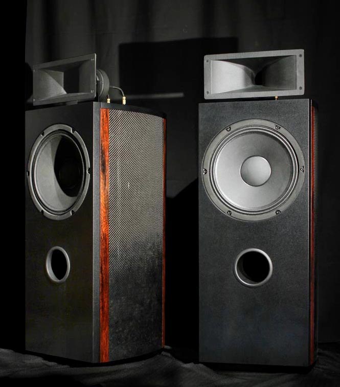

    Last but not least, I like the looks of a large cab with a horn or WG on top of it, like these loudspeakers by Polish manufacturer Ancient (of which the space between the drivers is still larger than will be the case on my cabs) .
