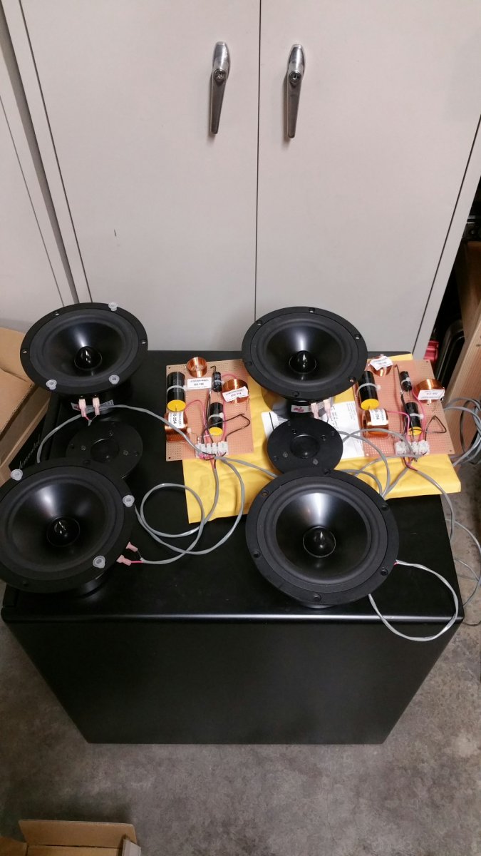

    I still have more Denham crossover PCBs if anyone would be interested, to help make finishing these easier. I know one can just use a piece of cardboard, globs of solder, and some hot glue to make a crossover, but that just doesn't work for me. Plus, having the layout clearly labeled makes putting in the components correctly a no-brainer. I'd also be open to suggestions for other crossover PCBs.
  17. I built mine in a MLTL tower format. I wanted the bass extension for full-range listening. My towers ended up being 42"x9"X14". PCBs would be nice, I have mine wired up and waiting for solder right now. For my own curiosity, can you tell me how much a PCB cost to make? PM me if you like.
  18. In a quantity of 10, PCBs of this size can be manufactured and shipped to the U.S. for around $5-$10 per board. What it costs in man hours and the experience required to create them is another discussion :) It could cost even less if you're willing to wait for shipping via a literal slow boat from China (2 months), and make them only to the minimum of electrical requirements. I'll admit that I overbuilt these with thicker board material, and gold plating, but I wanted them to be more physically robust, and to be able to pick up a pair of these boards in 5 years and have the pads and connections all still be fresh.

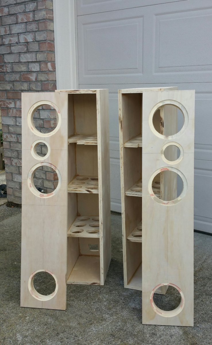

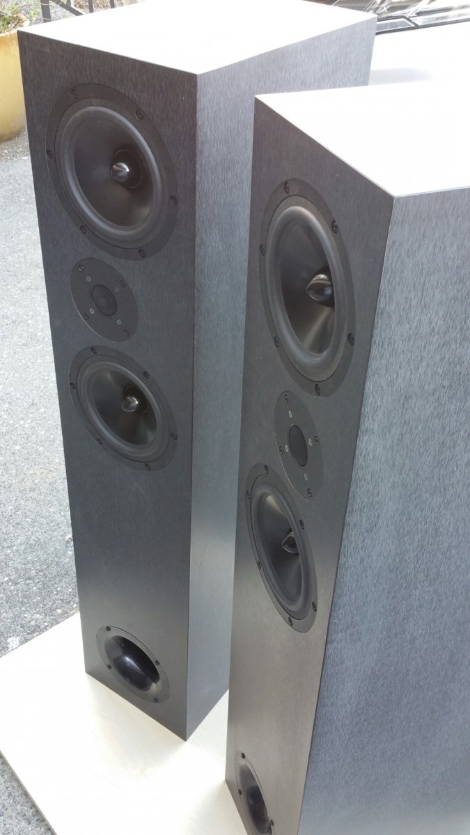

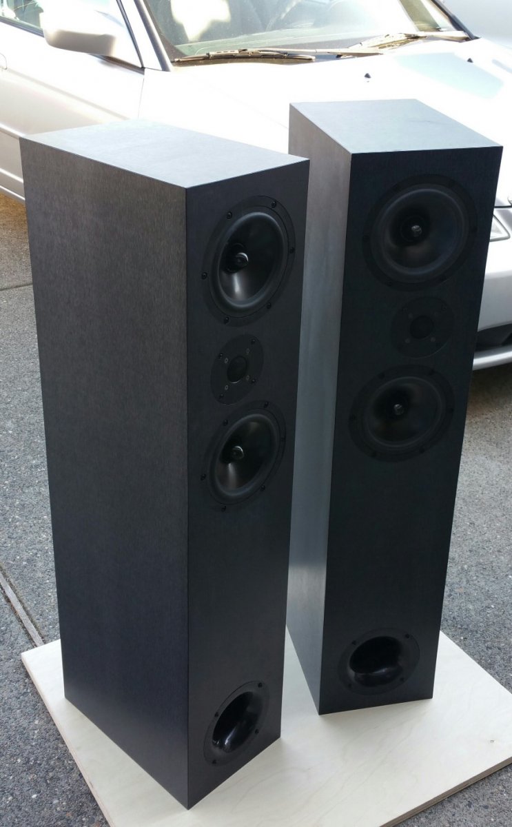

  20. For anyone following this thread or anyone interested in the Denham kit, these are great speakers. I just finished mine a few days ago, in a MLTL tower format.
    These are 42" tall, 14" deep, and 9" wide. The port is a 3" Aeroport, 5.5" long, which yields a tune of ~38hz.
