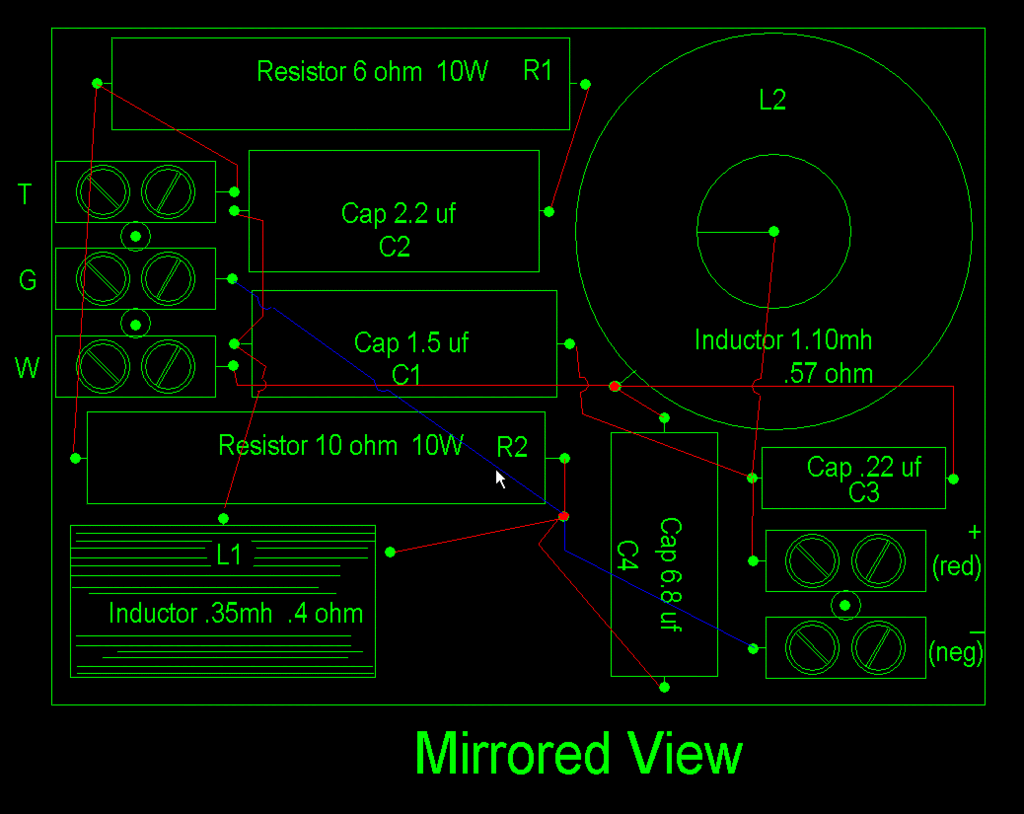

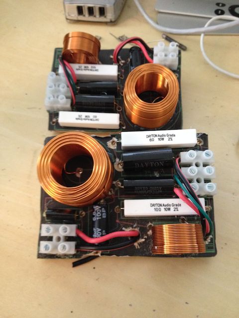

    Solder of Crossover is complete. I must thank Soundslike on Parts Express Tech Talk forum for the CAD drawings and connections. He even included the mirror image for wiring the back board. This made it easy. Hope I can show it.
    test fit the components. They fit!
