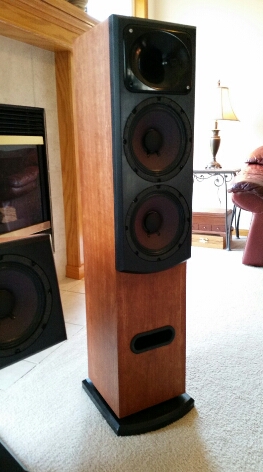

  1. I very recently finished my first set of DIY speakers... I am not an emotional man, but I cried a little when I listened to them. I feel I wasted 46 years of my life listening to poor quality speakers. I chopped off the bottoms of the included baffles and changed the round overs to chamfers. I made the cabinets a bit taller and blocked off the bottom of the inside to match volume.

  2. Does the crossover change since you have an extra woofer?
  3. These were the dual woofer 'tower' kits, found here:
    http://www.diysoundgroup.com/waveguide-speaker-kits/fusion-8/alchemy-tower-kit.html
    I also made the center kit, here:
    http://www.diysoundgroup.com/waveguide-speaker-kits/fusion-8/fusion8-center-kit.html
    All crossover parts were included, makes it all pretty easy.
    Of note, I did not use the flat pack for any of these because I was changing the overall cabinet look. If I were to make these the standard size, I would have definitely enjoyed using the flat packs. They sound fantastic to me.
    I didn't directly answer your question, but it should be sufficient.
