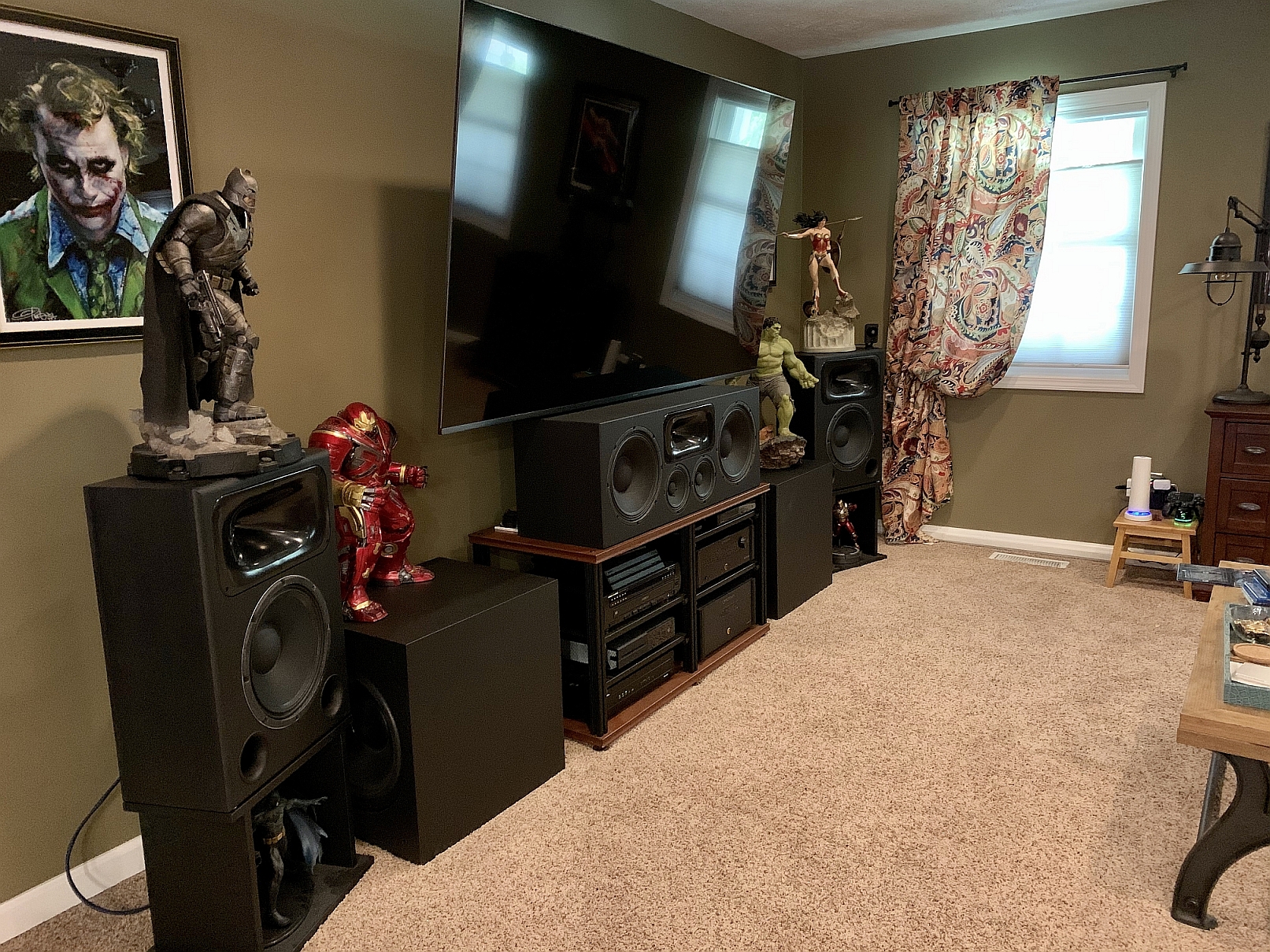

    My current setup has the bottom of my 82 inch TV 38 inches from the floor and the top at 80 inches. The reason is I wanted my front 3 speakers to be as close as possible to the same height. My seating is approx 12 feet from the screen which helps. I also have the TV angled so both the bottom and top of the screen are almost equidistant at the main seating position . The extra height comes in handy when I want to recline the chair a bit.
    I will add that with your 7.5 foot distance my TV height (38") is just too high. I do think your TV could be raised to 33ish inches from the floor and still be just fine.
