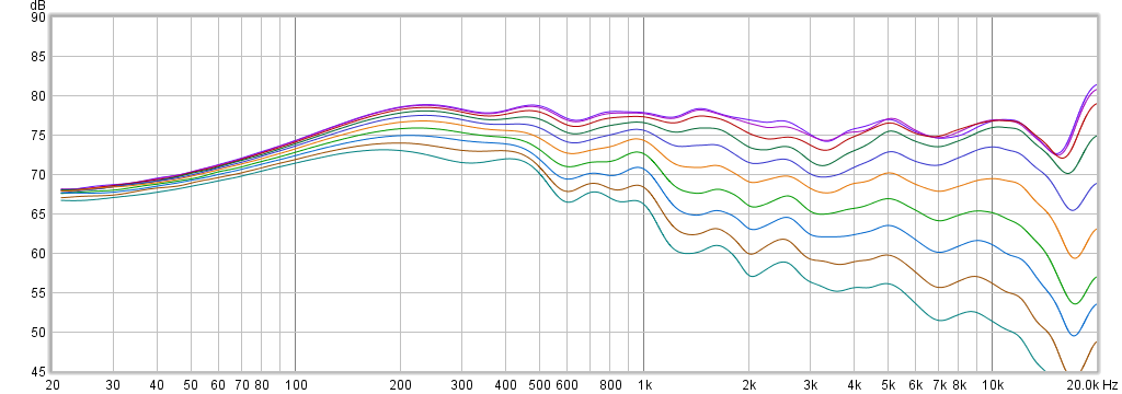

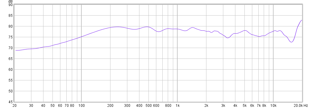

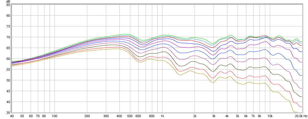

    I have been doing more reading about the importance of the off axis response / polar plots and also resonances and thus I have been beyond impressed with the off axis response / polar plot for the HTM-12.
    I have done some further looking and have managed to find the HT-12 off axis response on an AVS form (have not found the polar plot, but since it comes from the same date, I can easily visualize what it would look like) and it also looks pretty darn goodHT-12 off axis.png .
    What I am wondering is if there are off axis responses / polar plots for the HT-8 and HT-10 (to compare to the previously posted HTM 8 and 10 data). Its ok if the data does not exist, I am just wondering.
    Ideally I would also love to see the off axis responses / polar plot for the updated HTM-12. If that data is available that would be amazing and I think I would have enough info to commit to one (likely the HT-12 vs HTM-12).
