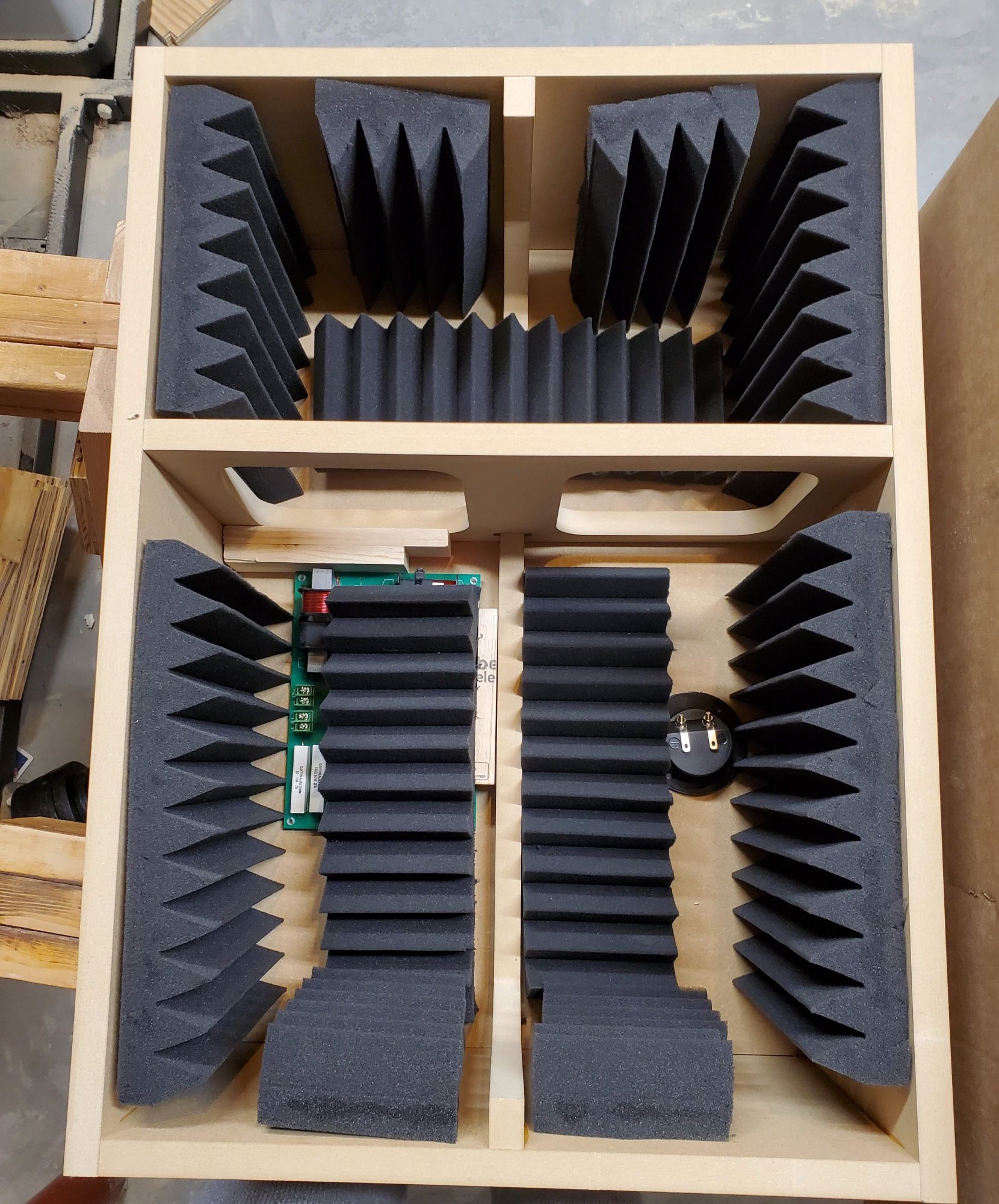

  3. I was wondering if this was an acceptable amount of 1.5in acoustic foam for an HTM-12. Should add additional polyfill on top of this? The box is glued up, but everything else is just placed inside for mock-up.
  4. That looks decent as you've largely covered the parallel surfaces, which is the goal. Hang them together and see how they sound. If you're unsure then you can always remove the SEOS and woofer after the fact to adjust things.
    I wouldn't add any poly-fill.
