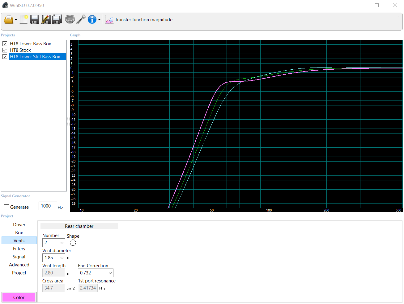

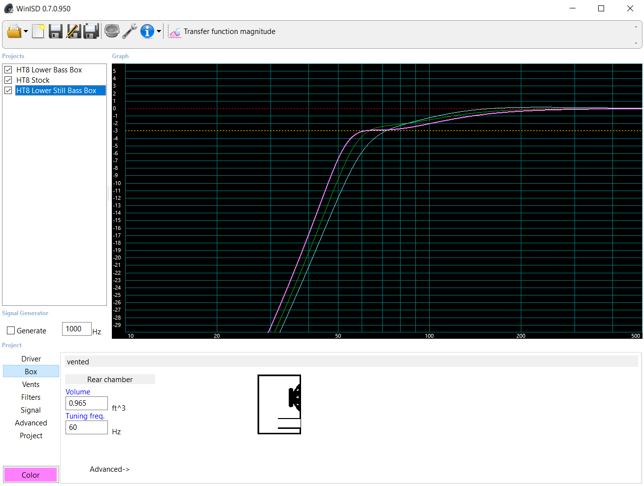

    So I'm not a wizard at Winisd, but here's a first attempt to coax a little more bass from the Celestion. I set the tuning frequency at 65 vs 70. Response dips slightly until 85hz (compared to stock HT8) but rises thereafter for a bass extension improvement of 7-8 hz. I also added a third model using a 60hx tuning and slightly larger volume. More dip, but over 10 hz extension (assuming I'm understanding all of this!)
    Vent length is about 2.75 inches. The only direction I can go with box expansion is UP since the HT8's will be in columns.
    Not sure it's worth the trouble - will I hear a difference?
  3. Erich H
    Erich H Administrator Staff Member
    Apr 24, 2016
    161
    102
    Cincinnati OH
    I wouldn't recommend changing the original design.

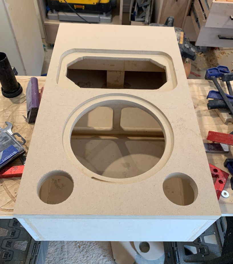

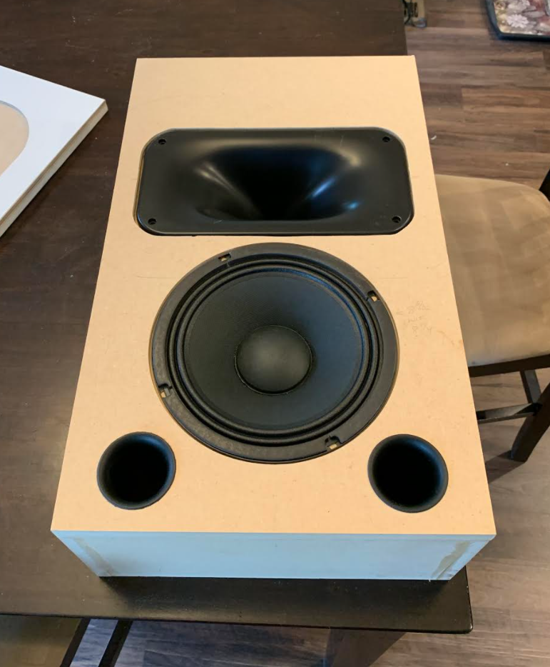

    I’m in the process of building custom boxes for my recently received HT-8 kits. They will be used as surrounds and flush-mounted in wall columns.
    A couple of questions:
    Will a 1 inch Walmart foam mattress topper be sufficient as a liner? Does it need to be glue in or fastened in some way? The preferred denim is not available in small quantities.
    The ports are a tad loose in the holes I cut out. I’m thinking of cementing them in with PL-3. Is there a better option?
    Lastly, since the baffle will be flush with the column fronts, should I keep the baffle edges square, or should I put a roundover on them? There will be a gap between the column front panel and speaker edges of less than 1/8 inch.
  8. Matt Grant
    856
    247
    The 1" Walmart mattress topper should be ok, I would just make sure you line the back, sides, top and bottom.
    When I have cut the holes for those press in port tubes slightly too large I'll tape the ribbed section with a few wraps of masking tape until the ports fit snug. But you can certainly glue them in if you wanted.
    No roundover needed if mounting like that.

  10. Clark Hathaway
    Clark Hathaway Member
    Aug 13, 2018
    21

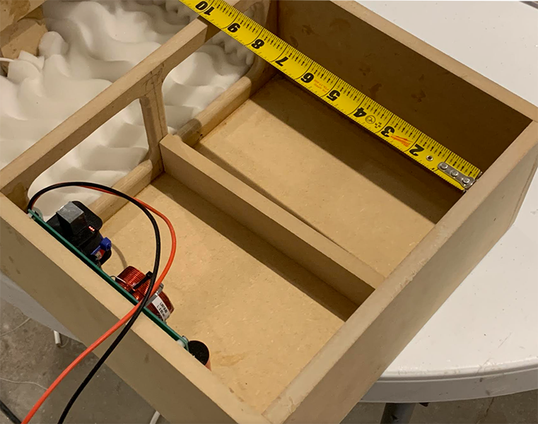

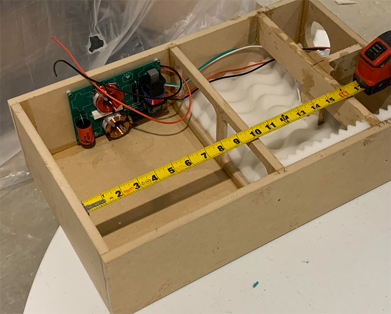

    Matt, here's a look at my ht-8 bracing. At the moment, the woofer section at 11.5 X 9.5 inches does not have any bracing. the mdf is 1/2":
    Should I add bracing to that section, or do you think it's ok as is - here's what I had in mind:
  11. Matt Grant
    856
    247
    It could benefit a little from a brace placed there.
