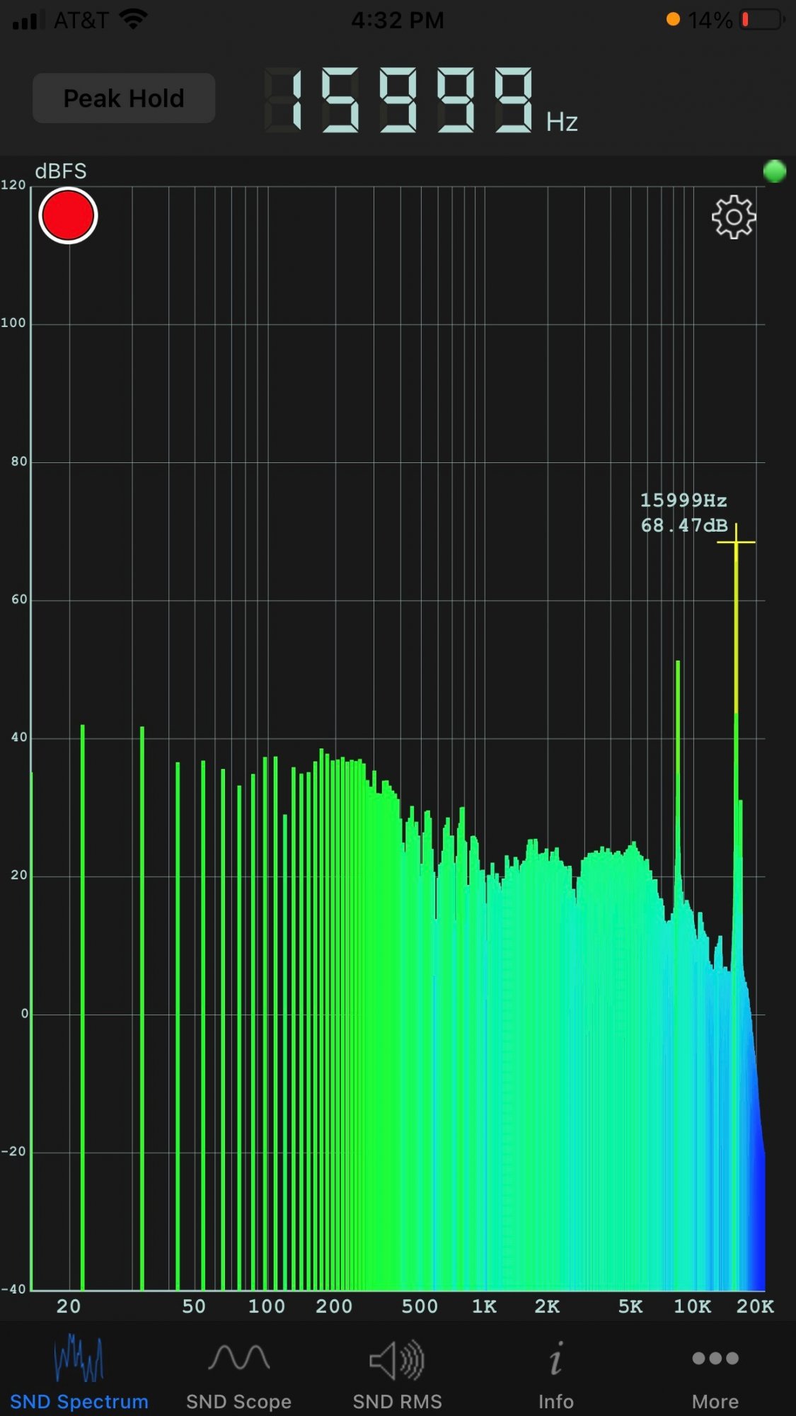

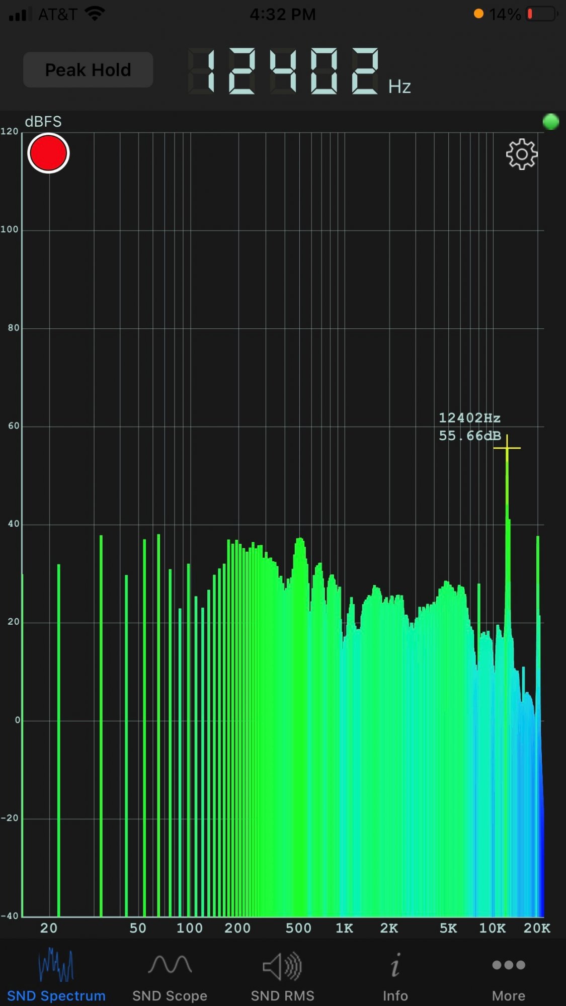

    I've had my HT-8s set up for a few weeks now and generally have been really impressed. However, I randomly decided to run a few sweeps this afternoon and noticed some weird "undertones" at high frequencies. The attached pictures are at 16khz and 20khz test tones. Notice in the 16khz test tone image there is a significant frequency at 8khz. And in the 20khz test tone image, the primary frequency measured is actually 12,400 hz!
    Has anyone had similar issues with this, or could help explain what the issue might be? Could it instead be my amp? How can I isolate the problem?
    EDIT: If I switch my AVR to "Direct", the problem goes away, so it's likely an issue with my AVR (Yamaha RX V385).
    EDIT 2: Problem is resolved when "Enhancer" function is turned OFF. This quirk might be something to be aware of for any Yamaha users, assuming it's not just an issue with my specific unit.

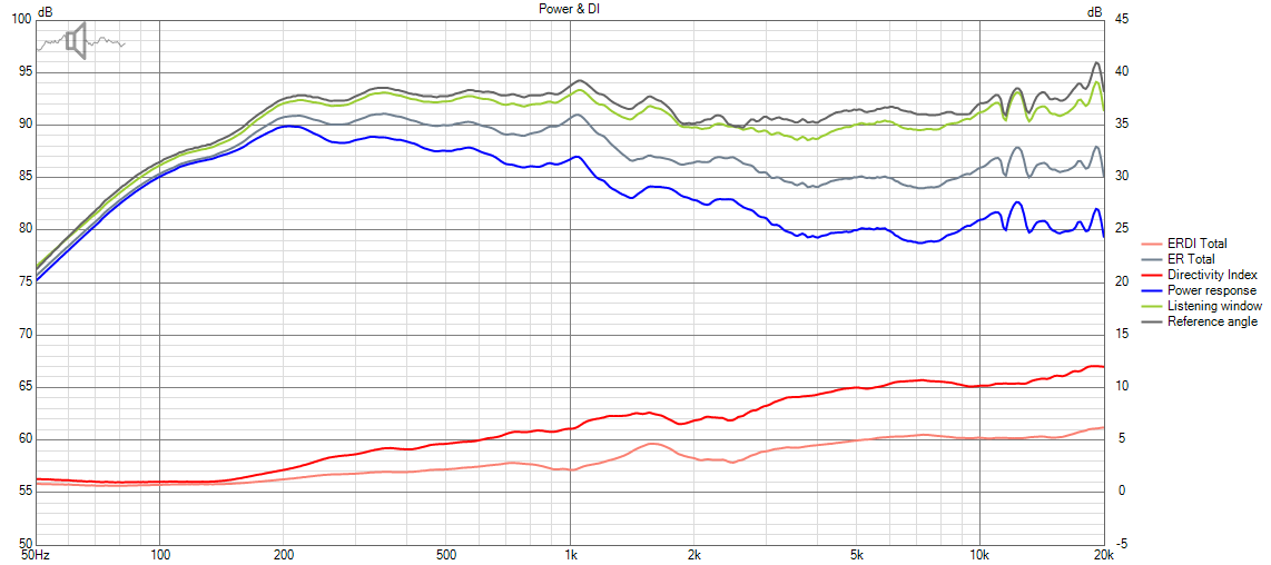

  5. Matt, do you think this result for the HT-8 suggests a higher crossover setting than 80 Hz? The data on the site says the -3 dB point is 70 Hz but it seems like this suggests that in reality it's more like 150 Hz, unless I am misinterpreting something.

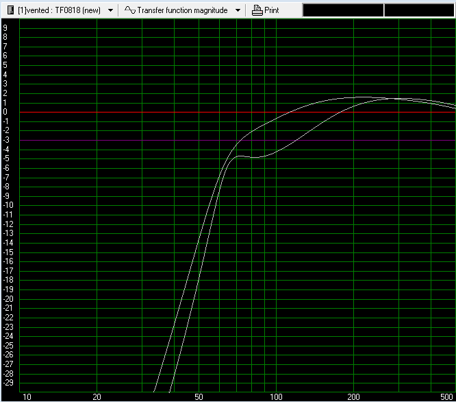

  6. Those measurements are performed 4pi and the bass does roll off slightly quicker then what is to be expected with the speakers placed in a room as designed. They are gated measurements as well and the resolution below about 200hz does become iffy. I still plan on taking ground plane measurements of the designs to show a more accurate low frequency extension.
    I may have thrown the oddball TF0818 woofer I have in that cabinet as well. I've got one where the Fs is ~136hz vs mid 90's of my others. That one has more sensitivity and midband output as well which is also why I think the treble looks shelved down so much (more then I had been expecting).
    This the modeled difference in bass response between the two TF0818's:

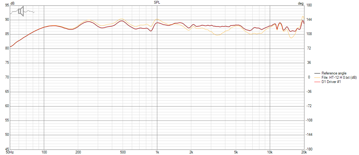

    For current HT-12 owners; would anyone be interested in an HT-12 upgrade crossover? It involves a near complete redesign of the crossover (taking it from 8 to 19 components) and greatly improves the response linearity and balance.
    Here is the expected difference:
    Basically I am just gauging interest in something like this and if it's worth getting boards made up for. These would be offered as fully assembled boards you just swap in for your current crossover. I still have to calculate the cost but will update with that soon.
    Edit - Would be $80 each for the fully assembled upgrade crossovers.

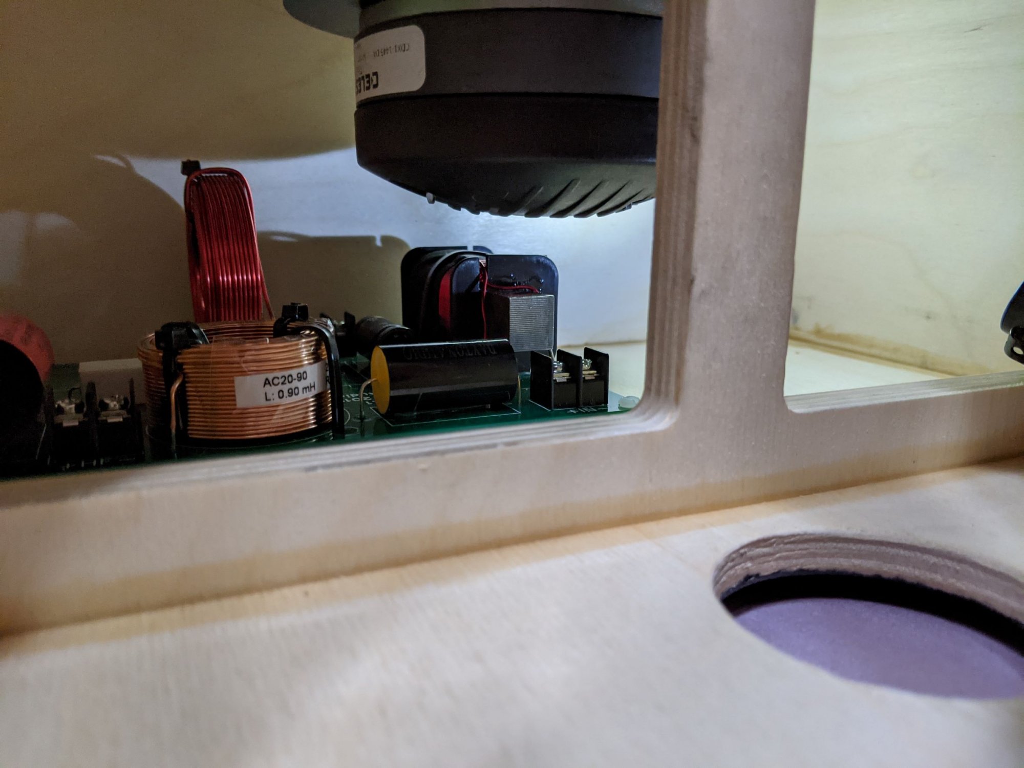

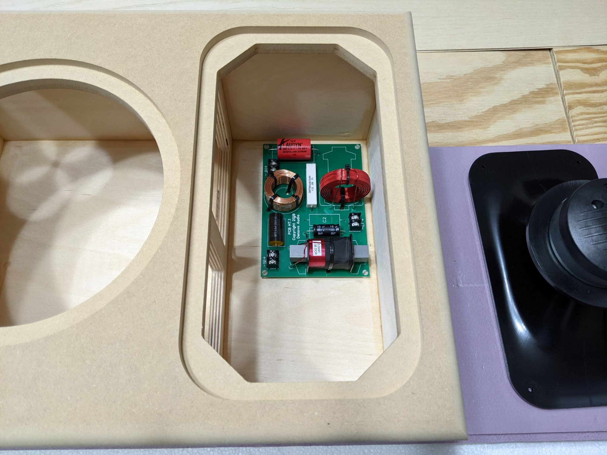

  20. Is this an acceptable location to mount the crossover in the HT-8?...
    Are there any concerns with its proximity to the CD magnet?
    Hoping Matt will weigh in, but welcome input from anyone with enough experience to answer definitively.
    Thanks!!
  21. Nope, that should be perfectly fine.

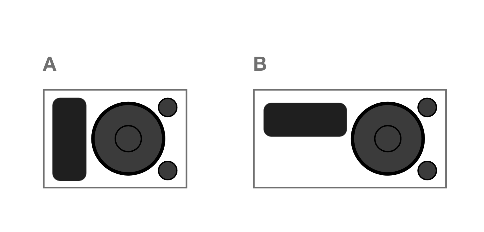

    I am considering a UST projector with an ALR screen. To prevent from getting nose bleed, I have to keep things lower on the ground. This means My htm12s will be below ear level. This will be in a 9ft high, 13ft wide room. I sit 10ft away which is halfway the length of the room. I am considering putting the html12s on its side. which one is better?
    Would option A help with a wider (vertical) dispersion to reach ear level. Also, being only 13 ft wide - im hoping I dont sacrifice horizontal dispersion since the room is not that wide. Option B- if this is even possible and worse case scenario since I have to remake the speaker box.
