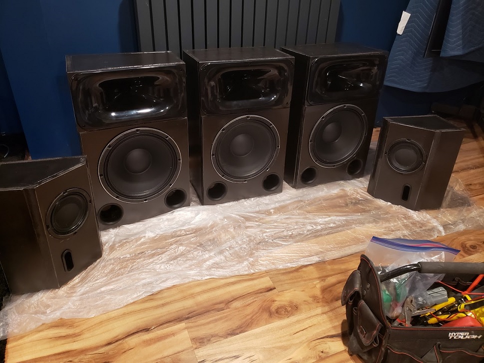

  1. Here are the HTM12s with a couple of surround Volt 6s. The enclosures are not the prettiest but they are hidden behind screens. There was just enough room to use the ports after all. They sound great. Matt, thanks for your assistance!02cr.jpg

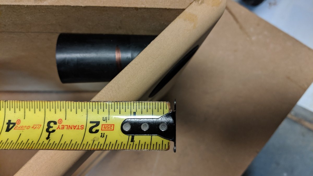

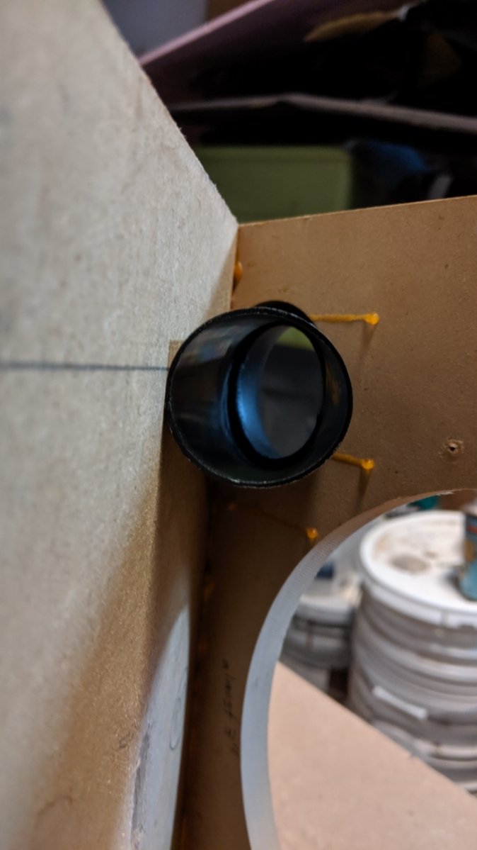

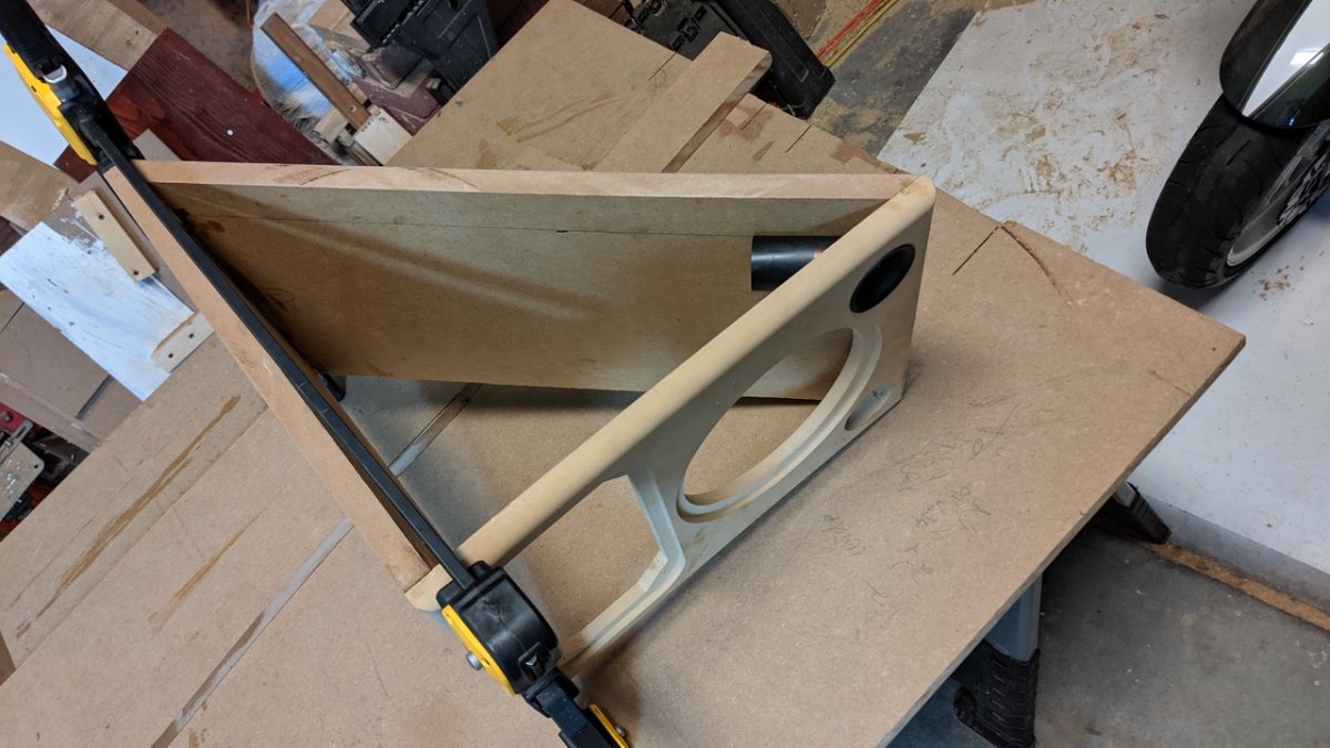

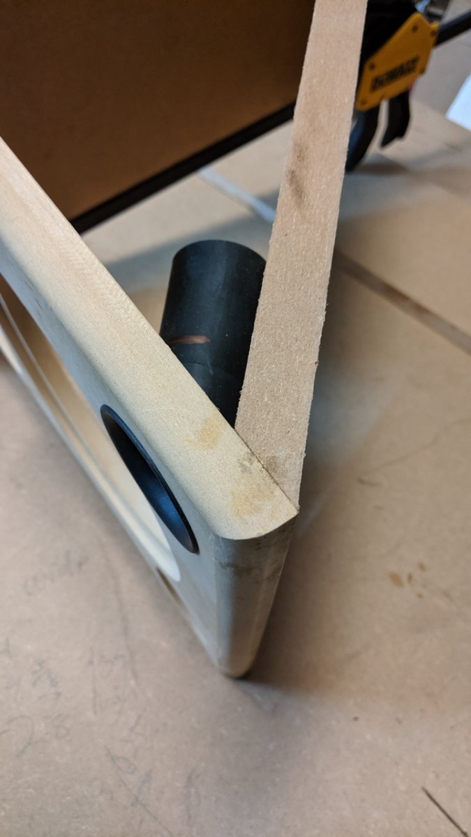

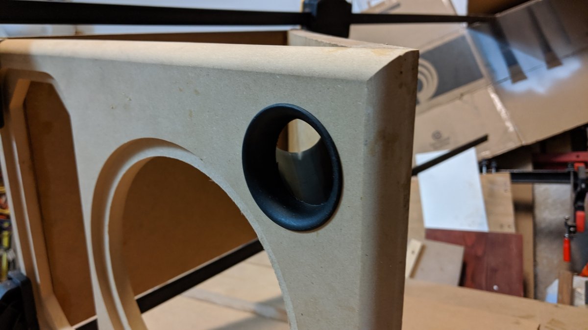

  21. Hi Matt,
    I am working on your new HT-8, I added some extra volume for a total of .96 without the drivers/port.
    Because of the way you answered my question about the volt 6, I was able to model the "Celestion" TF0818 with what I feel is flat enough yet low enough to cross over at 80hz.
    I was surprised that the 1.8"ish diameter port ended up looking good with the same suggested 2" length @ a 75hz tune.
    But I am a little perplexed since I am installing the port at a 45 degree angle, worse yet it ends up against the back wall (see photo) which I think adds ports length but how much is the question? Will 1.75" length from the port face 45 degree center work nicely or should I just keep it 2"?(I was going to tape extra length to the front and take REW measurements but it is at an angle inside)
    Thanks again for the help. Your speaker designs are so nice, I am sure these will be a nice Front Height Surround addition to the 1099s and Volt 6 rears. (of course with your VBSS filling in the lows)
  22. I'd try them with the port length they are right now and see where tuning comes in, you can test that with REW and the sine wave generator watching or feeling for the point of minimum cone excursion. If it lands somewhere between 70-80hz I'd say leave it as is.
