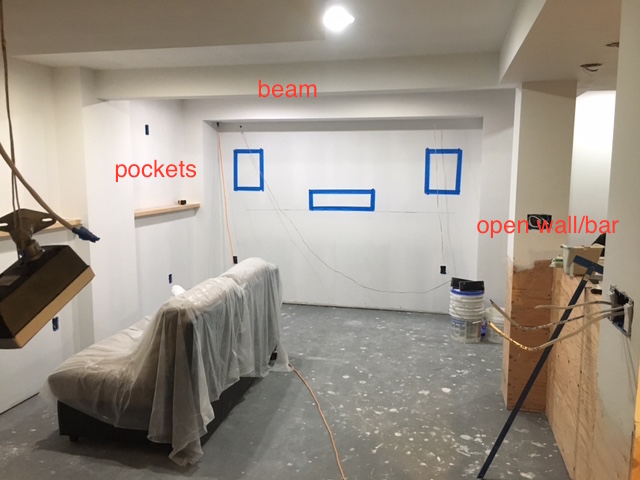

  14. Quick background.
    I got the itch to finish my basement about two years ago (DIY) quickly drew up plans and got to work. Wife wanted a bathroom (no more pool wet kids parading through her house) I wanted a bar (mostly for guests), home gym and a home theater of some sort. Learned framing/plumbing/electric mostly on you-tube. Fast forward today, for the most part all the walls are up bar is 80% complete (awaiting cabinets and counter tops) Bathroom 90%... awaiting a piece of granite for niche. so my focus is on the HT.
    Read a lot these past few weeks and realized that it takes a lot more that what I have available to make a decent home theater...I have no previous knowledge on acoustics/speaker placement and a number of things that the space i choose would be lacking. So basically it is what it is and I got what I got. Just got to make it work somehow. Please forgive my ignorance.

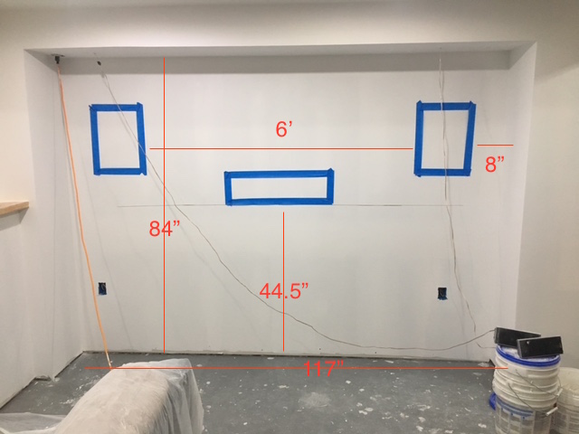

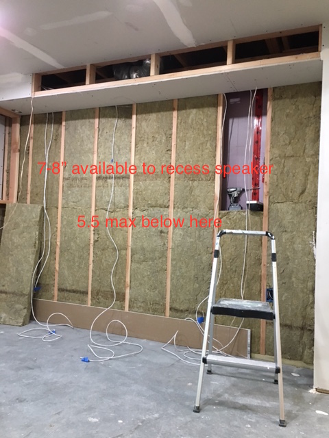

    I have been browsing this website and a few others for a few weeks and I ordered two HTM-10 and one 893. Didn't realize how small my area was until i marked off the possible location of front speakers (see pic)
    Reason I am attempting to stay above the brown line is the 4 inches of extra clearance, where i can recessed the speakers a bit more in wall...making room for my false wall and AT screen.
    Please let me know your thoughts.... can these work? I plan to toe them all in to focus on the sweet spot which ideally would be about 10 feet away but with the 6' distance between L and R....not sure

  15. why are the speakers so high ?

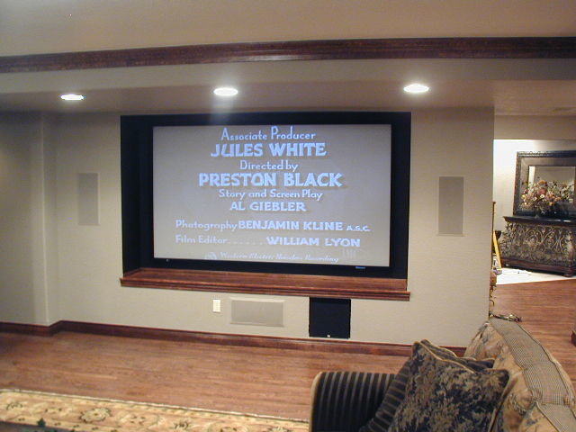

  18. In front of wall, i want to say about 16 inches recessed, but like i said i was hoping for the recessed look (sheer) no visible speakers
    wall will be simple and not load bearing...AT screen hanging on it. Unfortunately I was going for the sleek hidden look of UNFINSHED speakers :)
    I may have to consider one of those screens you mentioned.
    I was shooting for the first picture (recessed screen) but I may have to settle for picture 2....back to the drawing board

  20. Those tape marks for the htms are way to damn high

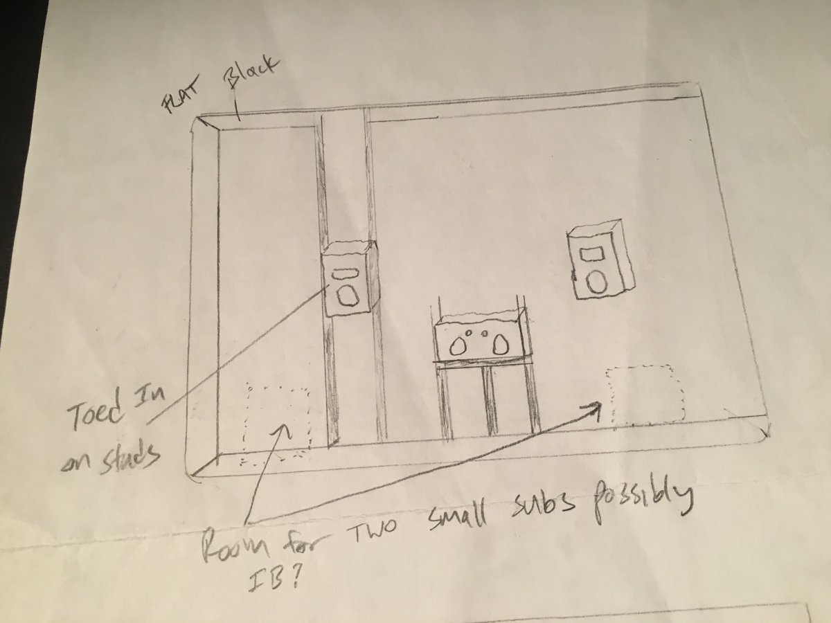

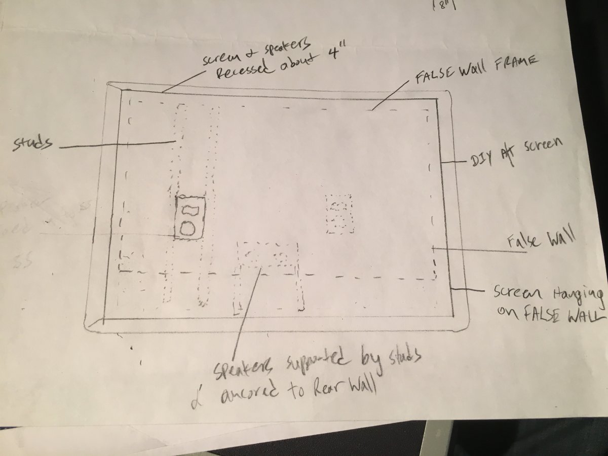

  22. I already purchased the 893 and htm-10's, awaiting the circuit boards. Been a bit busy...spring/yard work... I plan to have my new design drawn up and posted tonight.

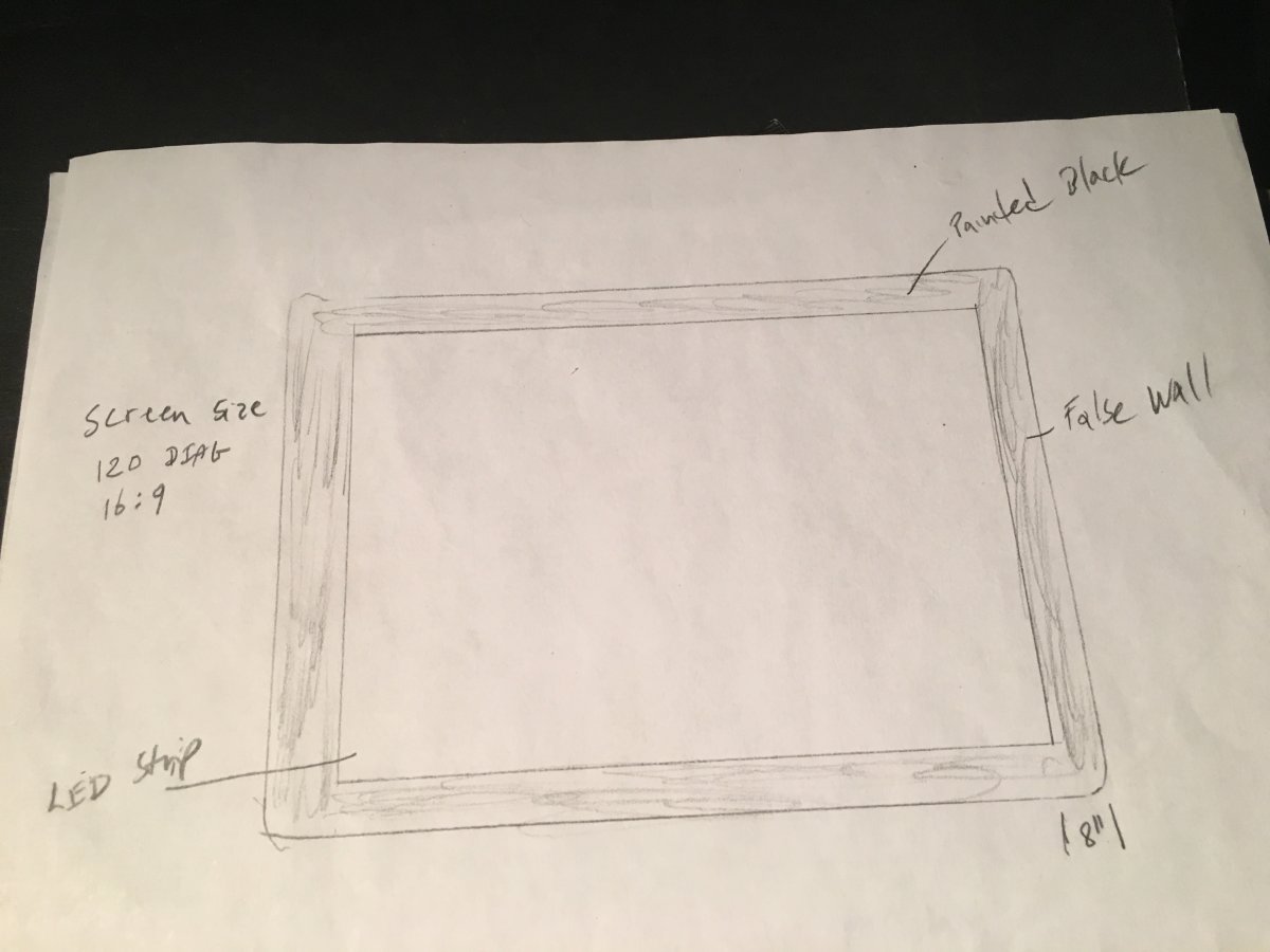

  23. Here is a sketch of what I'm thinking now after all the input received so far. As you can see, I can barely write much less draw....

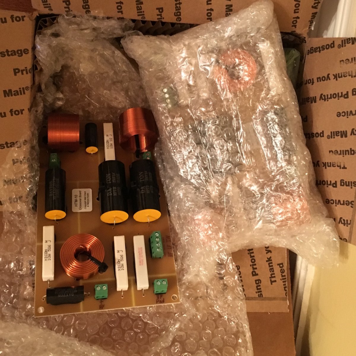

  24. Boards are here....time to purchase some MDF. Working on a cut sheet for Home Depot. My table saw isn't big enough for a 4x8.... did I miss a cut sheet for the HTM-10 and 893? Don't want to reinvent....
  25. Boards look solid. Thanks Matt Grant
