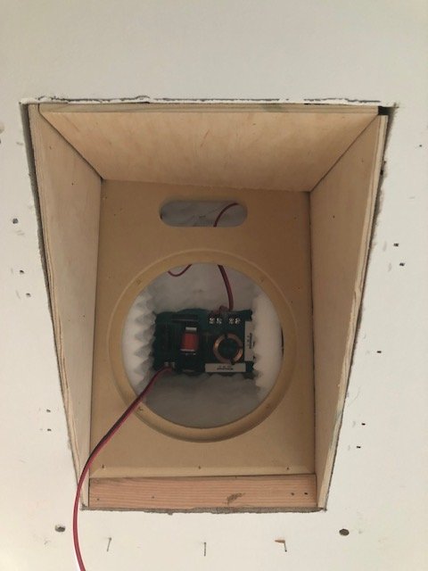

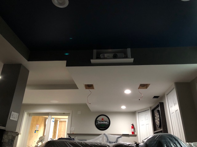

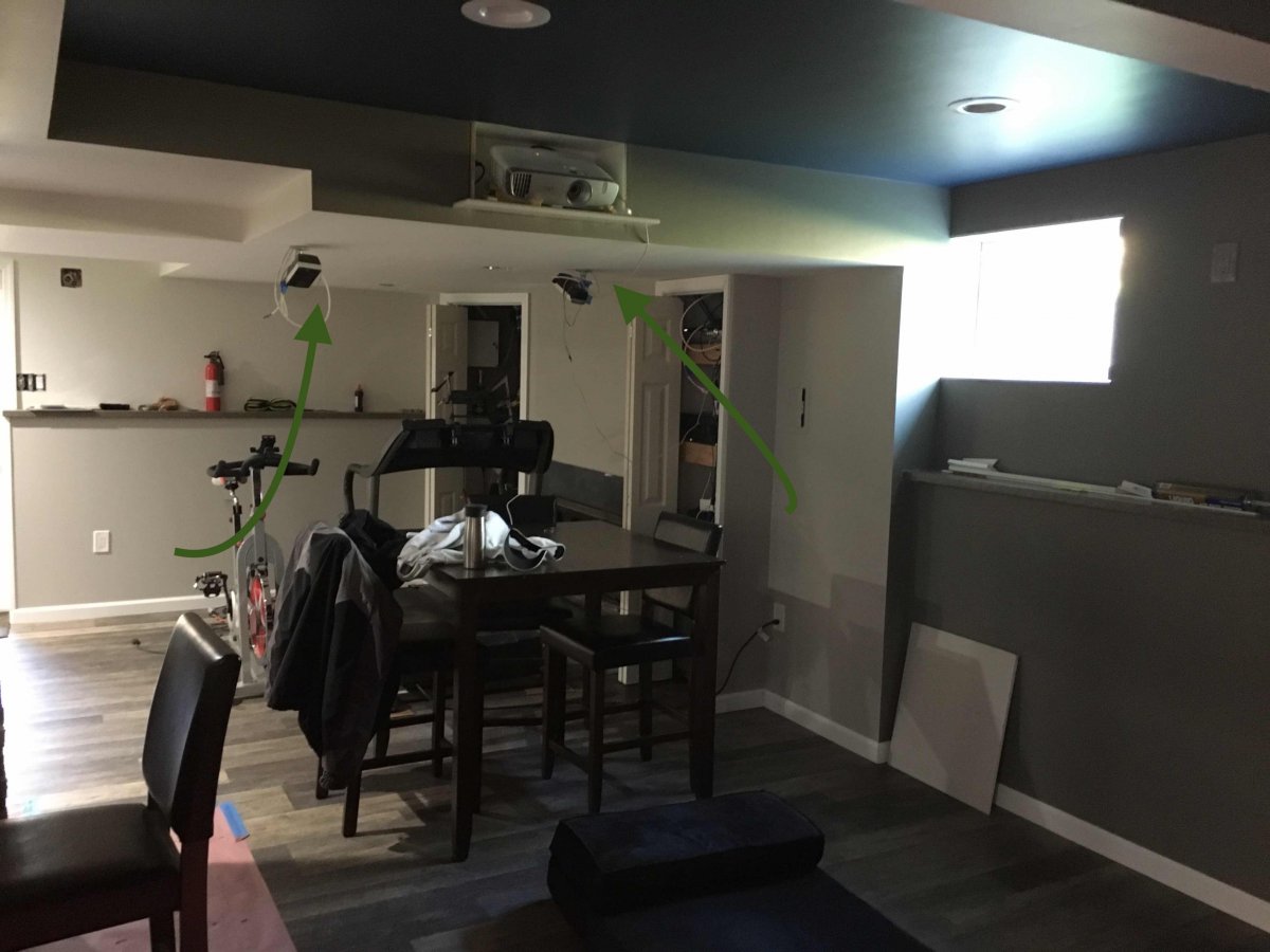

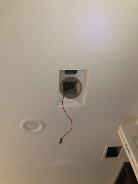

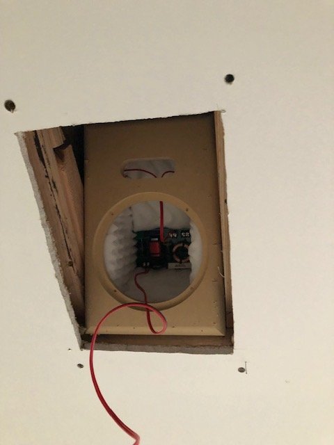

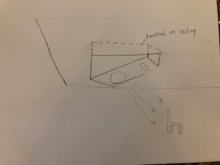

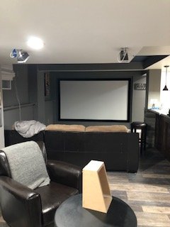

    Ceiling is definitely an option, I have my old speakers located there now and it works fine. There is plenty of room in that area (duct work). I may be able to recess and angle towards the sweet spot. See pic. I am guessing its about 16ft away from front wall. please see picture....Nolan do you still recommend the cobalt 8"? or should I try the HTM's or volts 6's?

    either HTM-6 or Volt-6 the specs are almost identical
    i would lean more toward the Volt-6 with the angled flat pack due to you having to mount them off a ceiling.
    Volt-6
