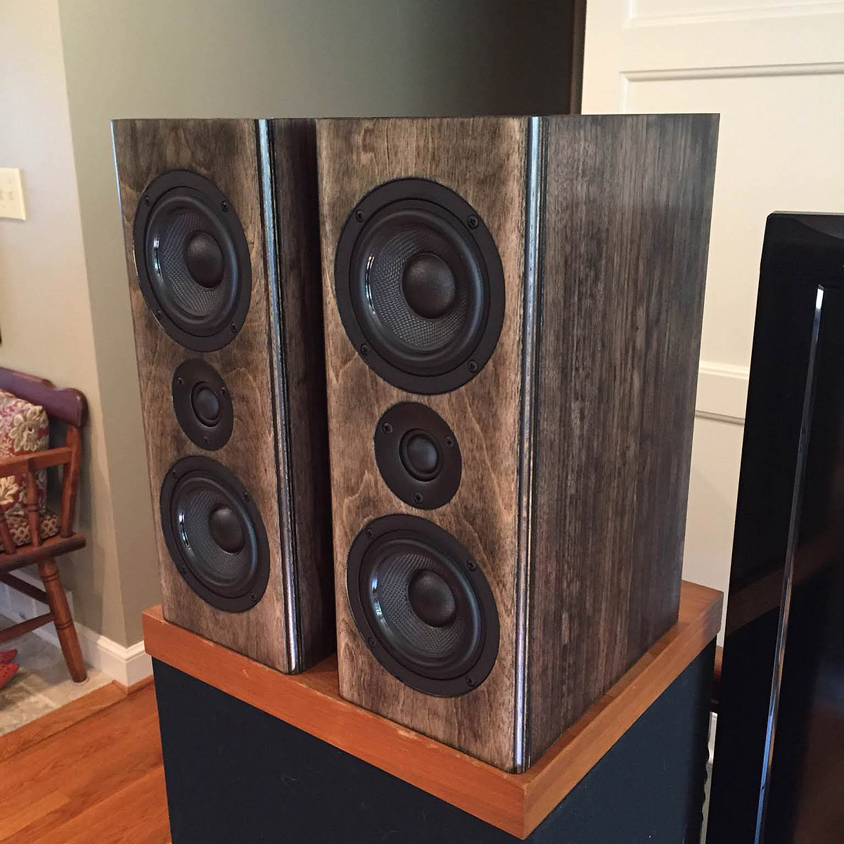

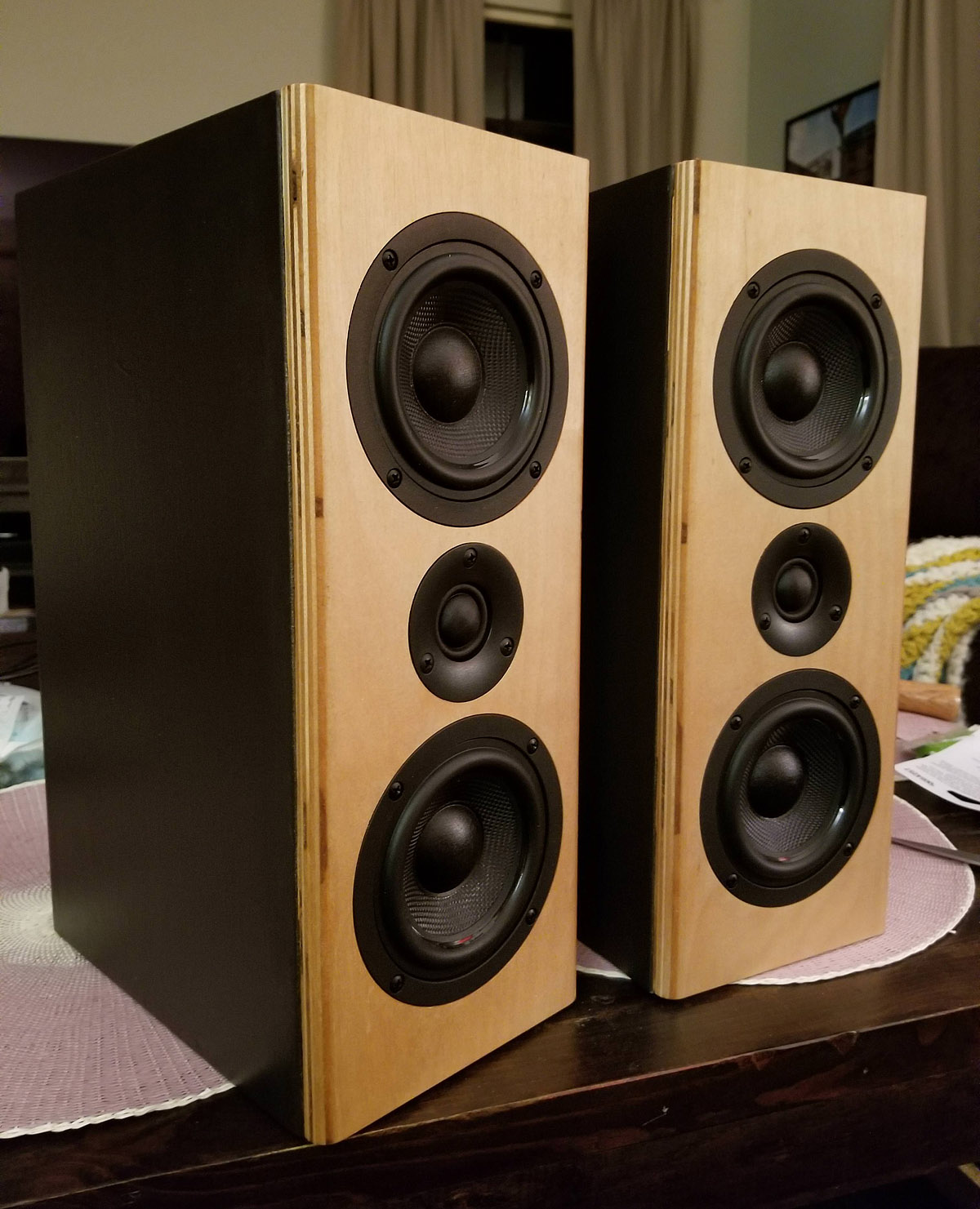

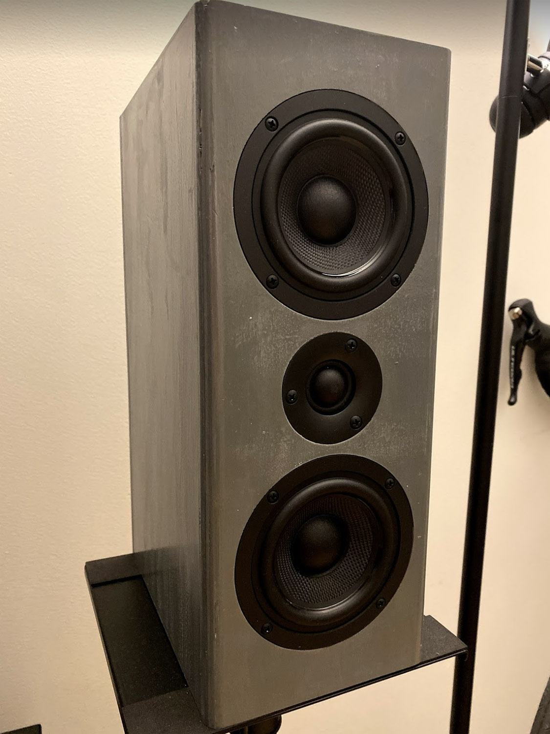

    Build Pictures: If you have any pictures or build threads of your S2000 speakers, please email them to me and I'll add them to the gallery below.
