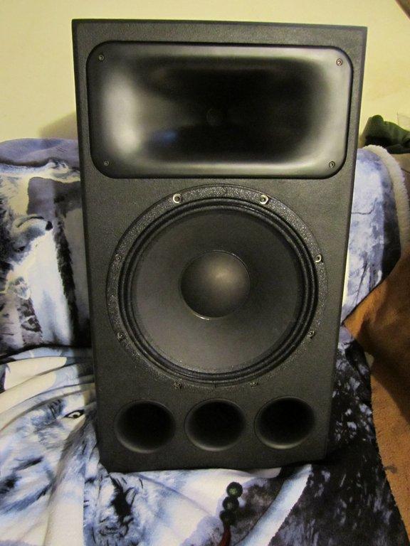

    I just built a set of Tempests and sprayed them inside with Zinsser after the cabinets were fully
    assembled.
    All that was left to do was painting the outside with many coats of Duratex, spray gluing some egg crate foam in the bottom and stuffing the waveguide area with Dacron.
