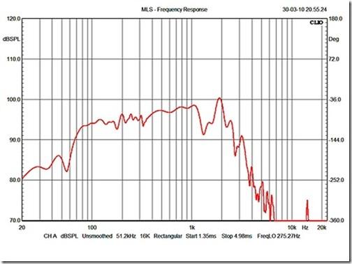

    This is a 12" JBL clone that works in a small box. 2 cu.ft should have a -3db at around 40 hz.
    Here are the driver parameters:
    http://lautsprechershop.de/pdf/beyma/beyma_12b100r.pdf
    Not exactly "econo", but very high quality.
    Anyone have experience?

    That is a very interesting and unusual speaker. IMHO not very expensive for it's quality. Perfect for mid-size box working down to about 40hz. Mid-Hi efficiency.
    (higher than Designer 12's)
