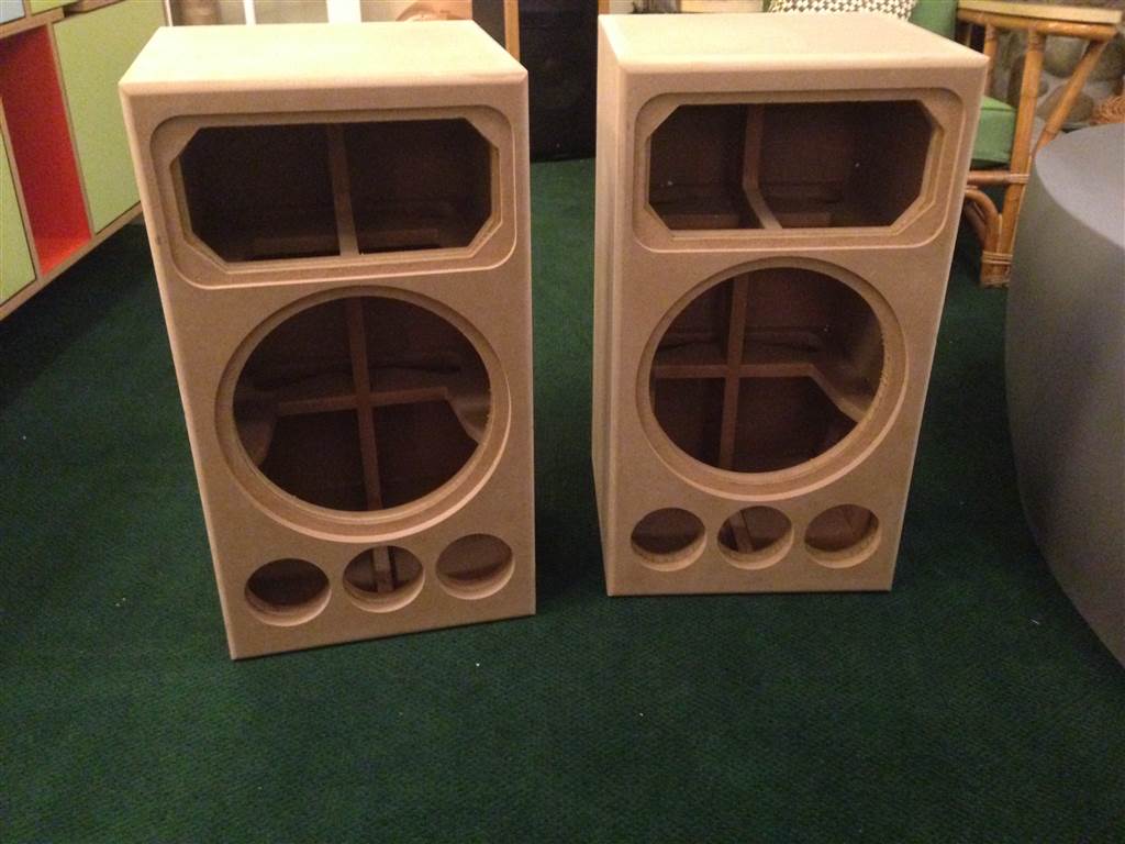

  19. Here is a pic of the assembled cabinet.

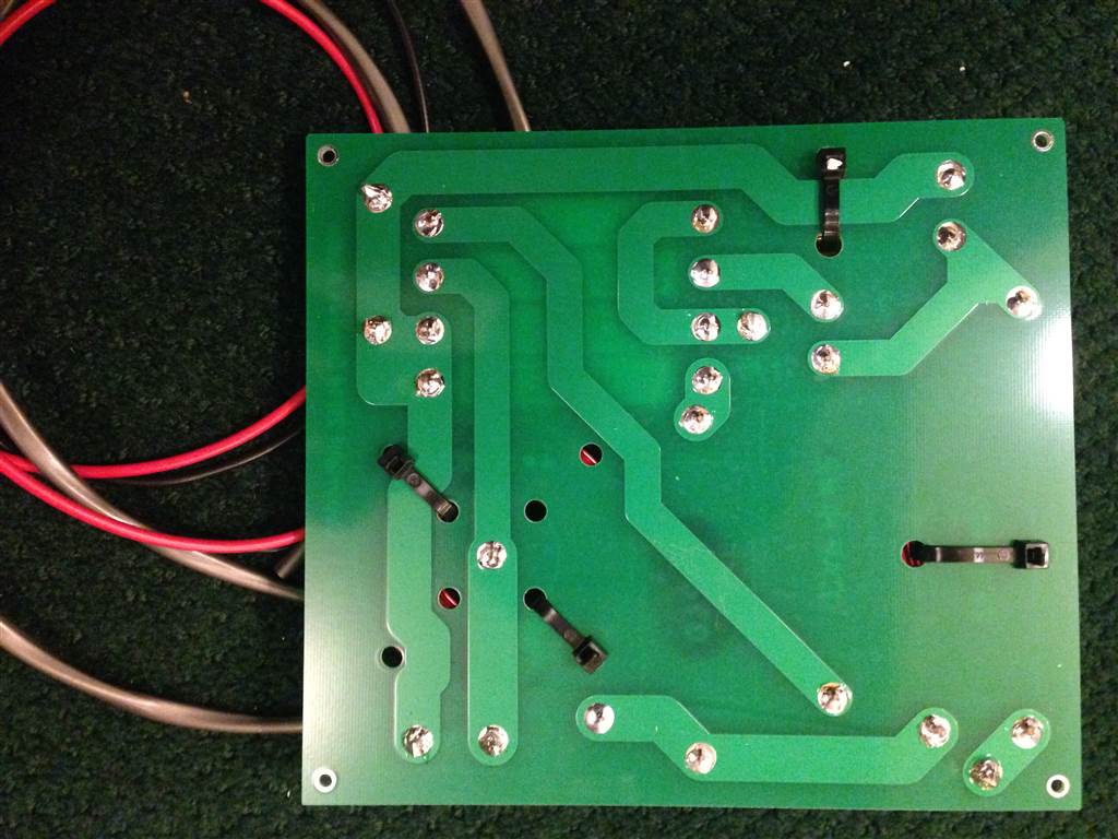

  20. Assembled crossovers.
