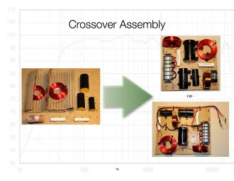

    The guide is complete through the crossover assembly, but doesn't have details on sound deadening, putting the front baffle on, attaching the speakers, final finishing the outside of the box, etc. I have done most of those steps but haven't added them to the guide. I also just setup both in their final spots, so I can't do a detailed review, but first impressions are very good!
    Hopefully this guide is helpful to others! Thank you to Jeff for designing the speakers and Erich for the flat packs, website, etc.! Also thank you for all those who actively answer questions in the forums!

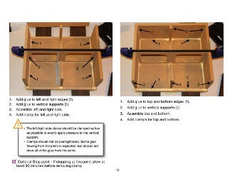

    I attached thumbnails for two of the pages to give an idea of how the guide is setup.
    The link is to the full 25 page guide and is approximately 5 MB lower resolution PDF version of the guide (ebook resolution). The full version is closer to 7.5MB, but I think the smaller file is high-enough resolution to be useful.
