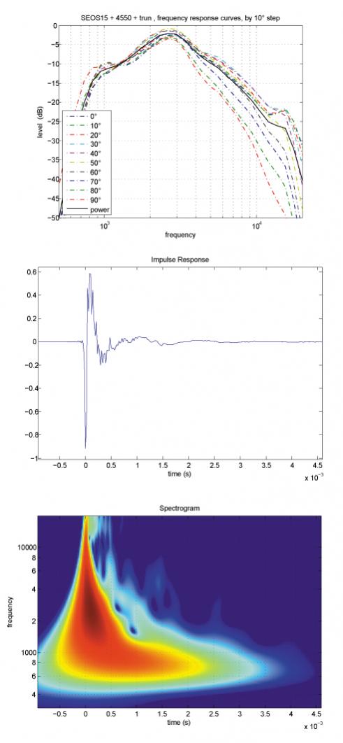

Bill, can a spectrogram be derived from that impulse response? I wanted to do an apples to apples comparision with the BMS 4550/SEOS-12 measurements done by jzagaga:
