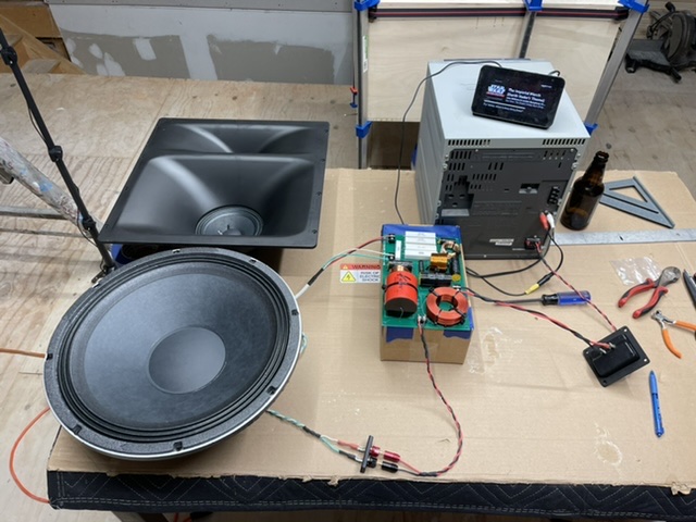

  1. Thanks for the info. I might give that a try. If I also get around to measuring them outside again, I'll try gating the response a bit and taking more measurements. Thanks for your help.
  2. Well, I ordered the parts. Hopefully I'll get them installed next week. Not sure when outside measurements will be completed.

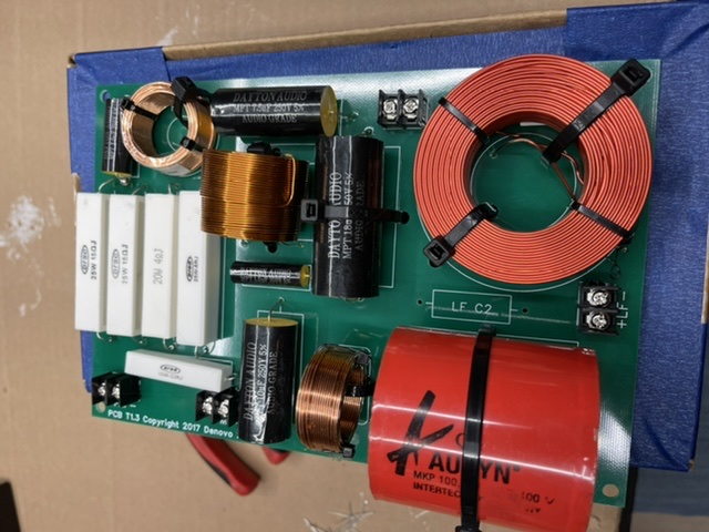

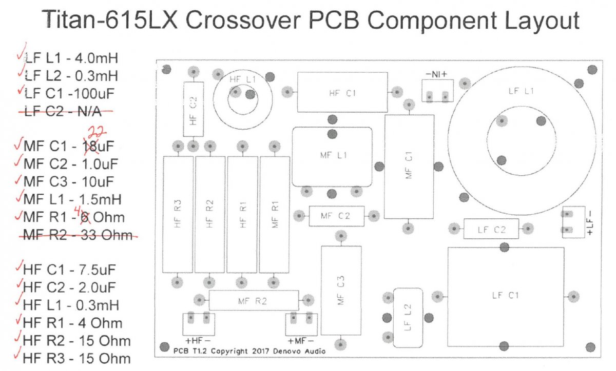

    I'm building mine now with the only crossover mods being the omission of the 33-ohm MF R2 resistor, the MF C1 cap increased from 18uf to 22uf and the MF R1 resistor decreased from 6-ohm to 4-ohm (all recommended by Erich/Matt). Once built I'll throw some measurements and feedback up here.

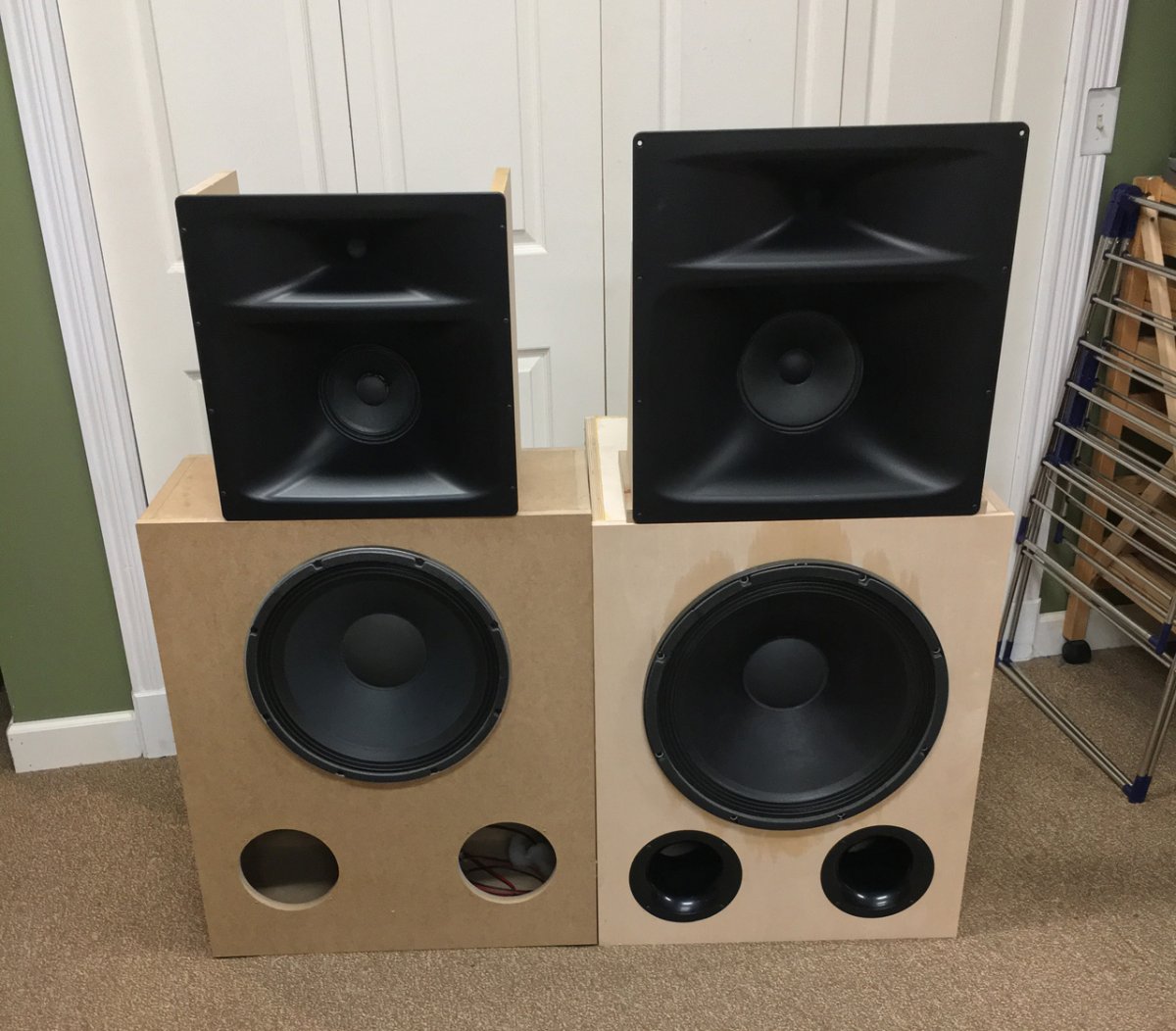

    Teaser Pic.
    Wags, LuisV, Jedi940 and 3 others like this.
  9. Those look awesome. I'm looking forward to seeing price, footprint, frequency response, and polar plots.
