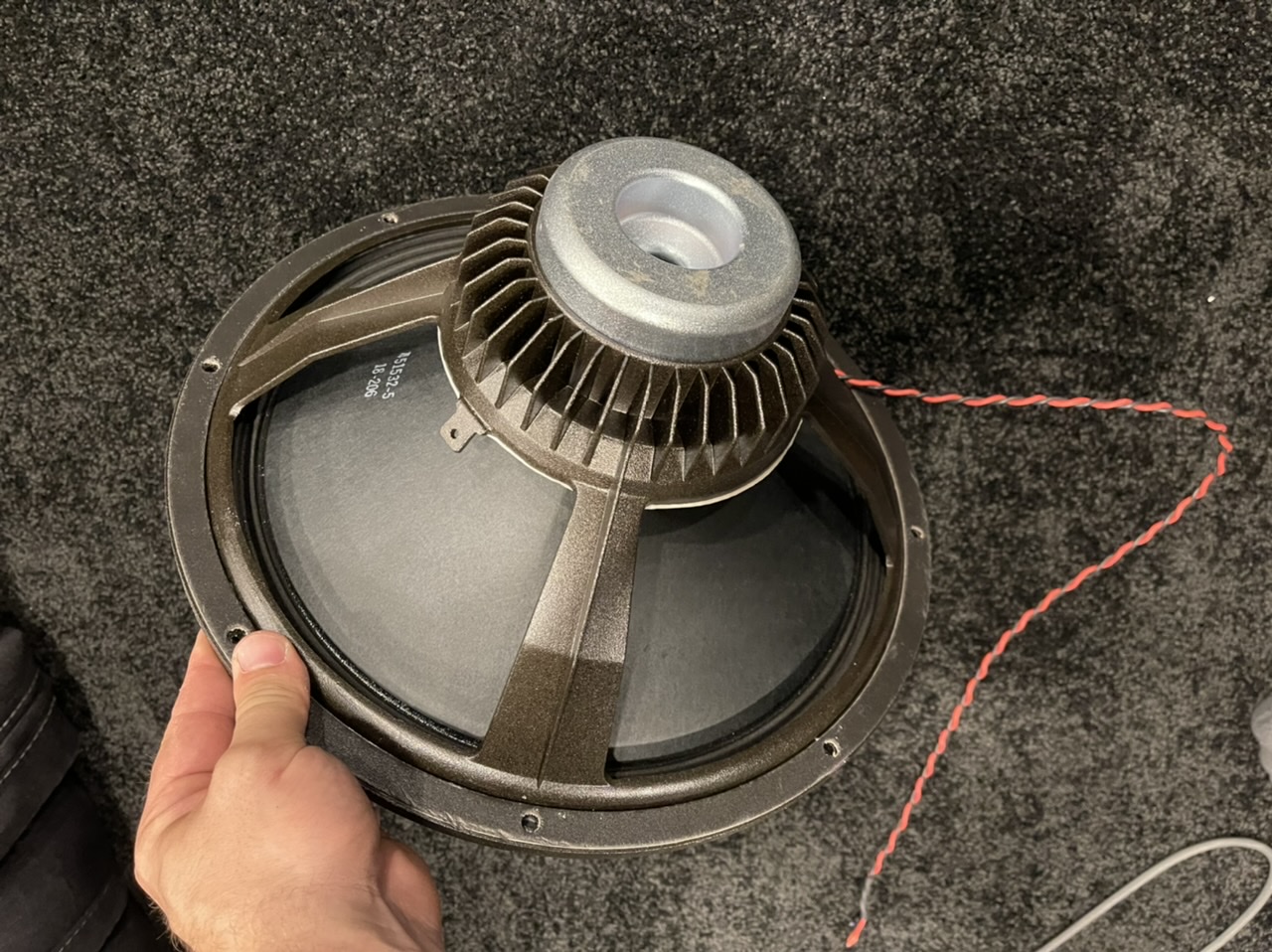

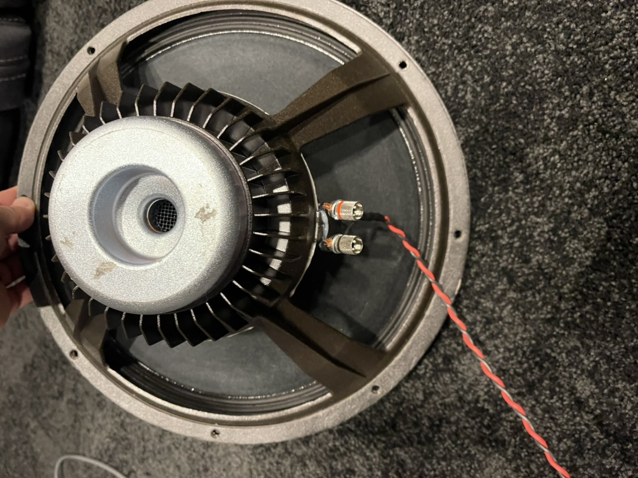

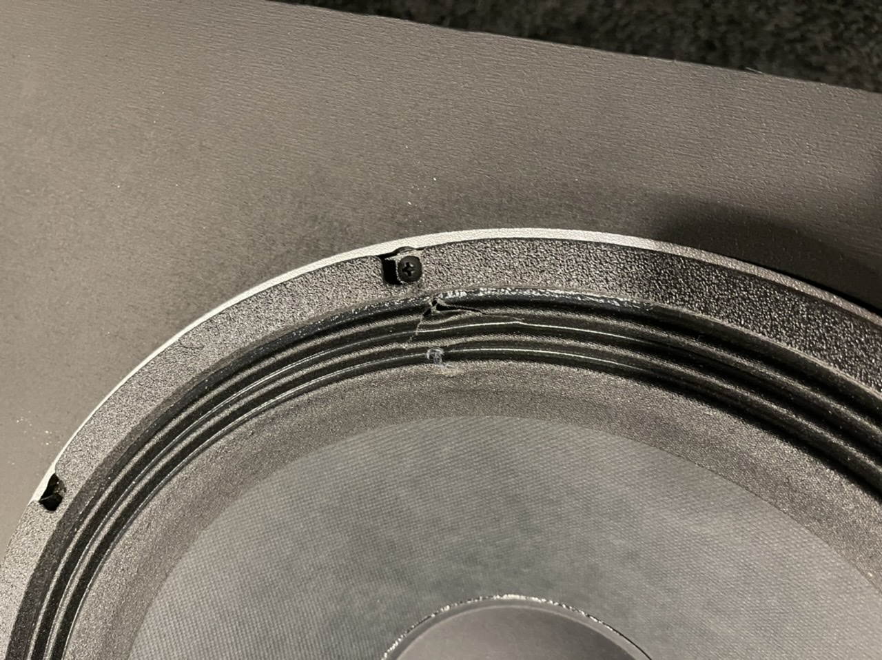

  6. Hey Guys, I stabbed my 15” driver during final assembly. If I wanted to match the other two (and I do) can I just get the $250 Eminence Kappalite driver from Parts Express or is there a custom driver at play here?
  7. That may be fixable with some Goop adhesive, should just need a thin layer to hold the surround together.
    Otherwise you may be able to get a replacement driver from Erich.
  8. Thanks Matt. I’ll try the Goop while I wait for Erich to get back to me.

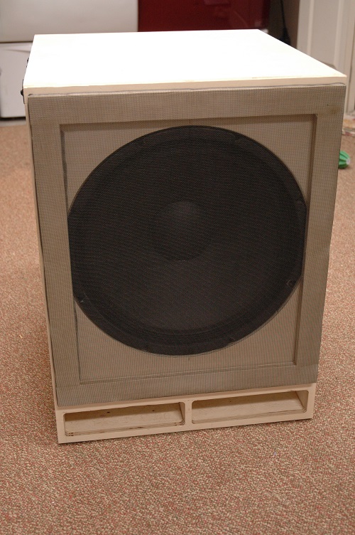

  13. Is the VBSS 18 used for the Titan 818LX?
  14. #114 Skoonky, Aug 14, 2021

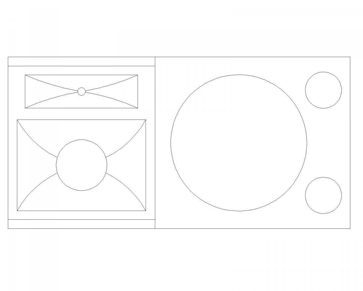

    Would it be possible to shrink that woofer to a 10"/(2) 8" and make it a matching surround for a Titan? What is the minimum depth of the waveguide assembly with the compression and midrange attached?
    Could you get away with running the 8" lower and remove the woofer all together for a surround?
  15. One of the bass enclosure options for the 818LX is a VBSS style enclosure but the designs do not use the same woofer.
    The midrange driver is sealed back so it can't play much lower then what it's currently crossed at. The waveguide isn't designed to to be mounted in a shared airspace with a woofer so you can't use a normal 8" driver on it and run it as a 2-way for the same reasons. Using a pair or four smaller woofers with these waveguides has been discussed before but nothing has gone past just talk.
