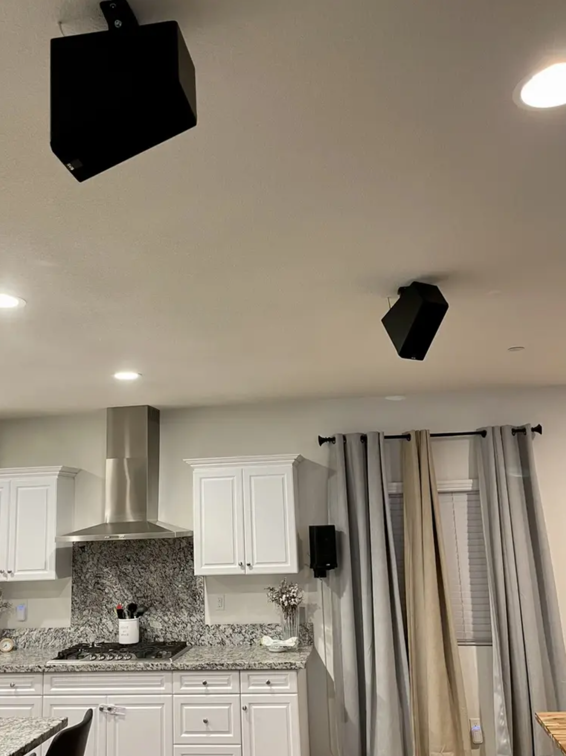

    I recently finished a pair of Volt-10's for my shop, these things sound fantastic. I also have a set of Volt-8's to build, just no rush to do anything with them yet.
    I would go with Matts advice, he wouldn't steer you wrong.
    If you have the Volts build them and try them, I do not think you will be disappointed.
    But if you don't have them, you know how hard it is to buy them, stick with something that is available,
