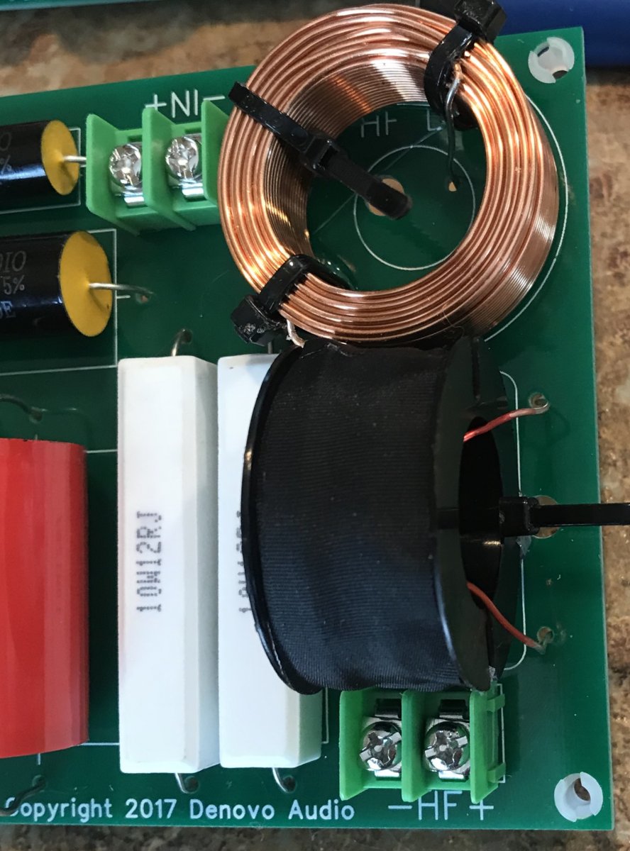

  3. For the new Volt 10 V2 crossover does anyone know if I have the black inductor or the bare copper inductor in the right location? Or does it not matter?
  4. Does not matter, they should be the same value.

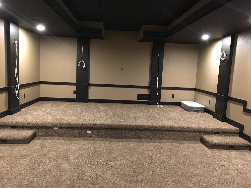

  20. Hello, I'm trying to decide on whether to use the angled flat pack mounted at the top of each column for my side and back surrounds in my theater room or do I go with standard box mounted lower on the column I'm considering the Volt 8 or Volt 10 for the surrounds mounted on the columns in the picture included. My theater room has two rows of seating and is 16.3' wide by 24' long so I'd like to make sure the side surrounds cover both rows. I plan to add Atoms speakers (likely mounted in the soffit ceiling) but I am concerned that using the angled flat pack mounted high for the surrounds could impact the atmos speakers. You can see from the picture that I have a wide (4') soffit around the perimeter of the room which gives approximately a 6.5' ceiling height (relative to the soffit) from the riser and 7.5' ceiling height on the lower level. Any suggestions? Thanks in advance for the help.
