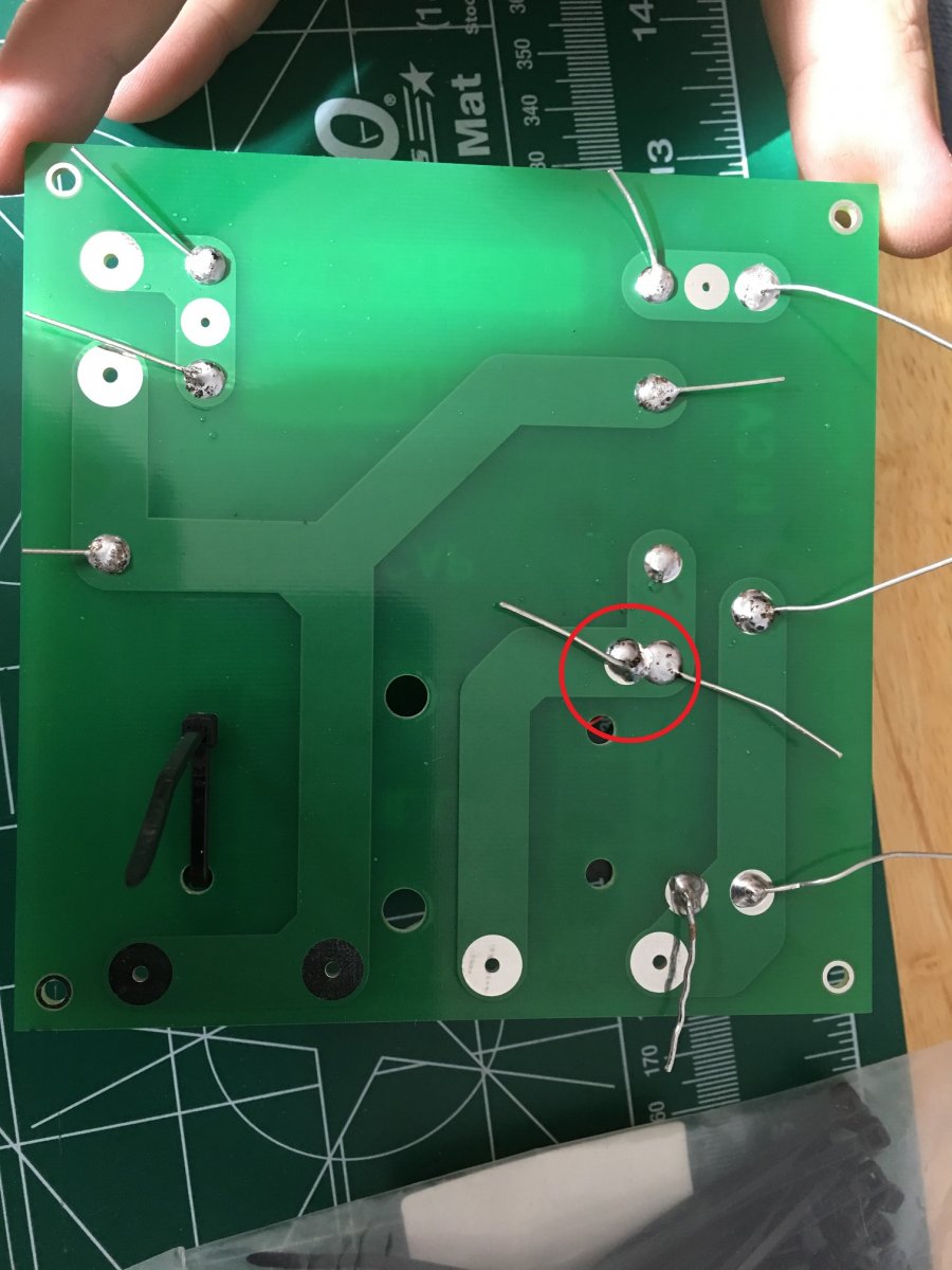

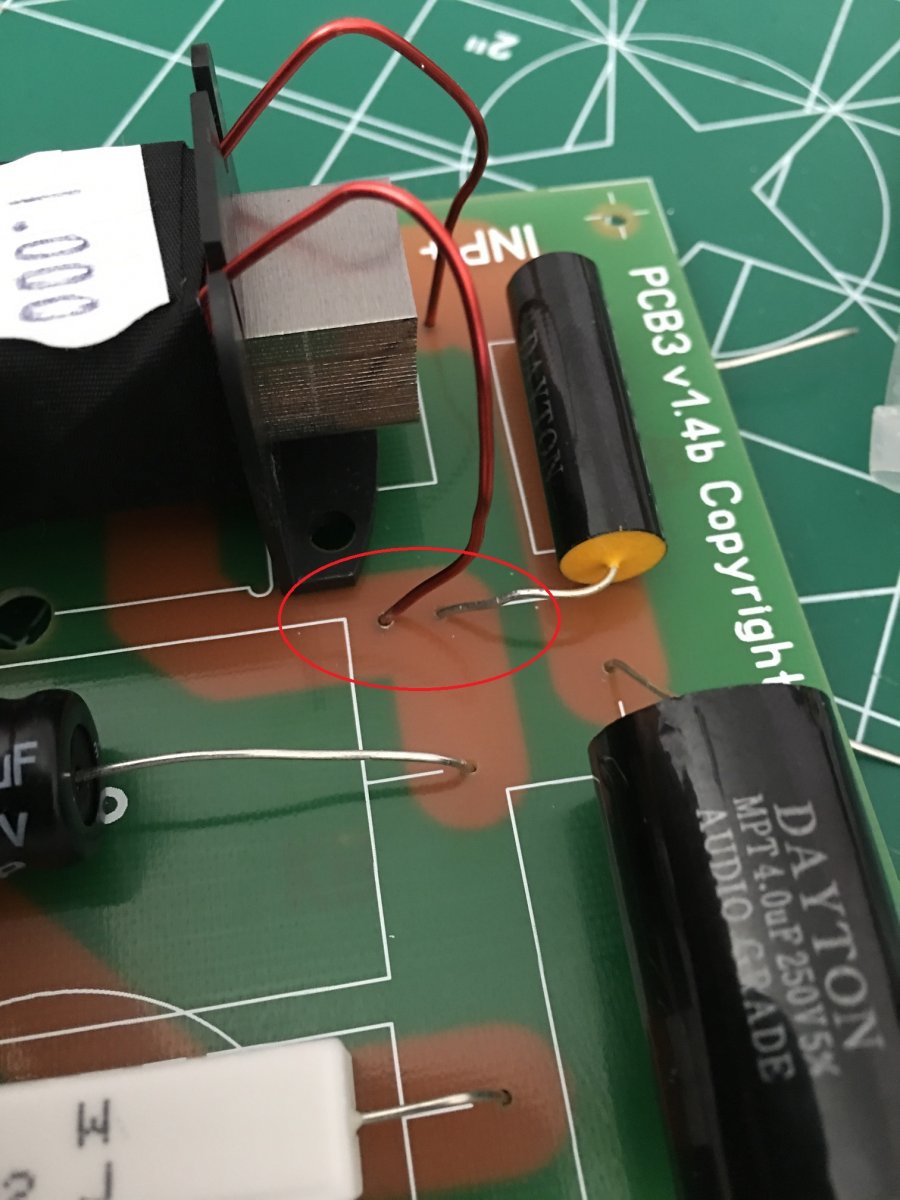

    Can we get a check on this soldering point? The area in question is highlighted in a circle.IMG_3484.JPG IMG_3485.JPG

    The two leads looks like they connect to the same trace on the board, so it's not a problem if the solder joints touch.
    A few of your soldering joints look's like cold soldering joints. In the first picture, the ones on the top row and the third one down on the left side. A properly heated soldering joint should be shiny.

    Yeah before I saw this I made the same comment on the OPs original thread. All the joints should be gone over and checked to make sure none of them are cold. That one in particular don't look too good.
