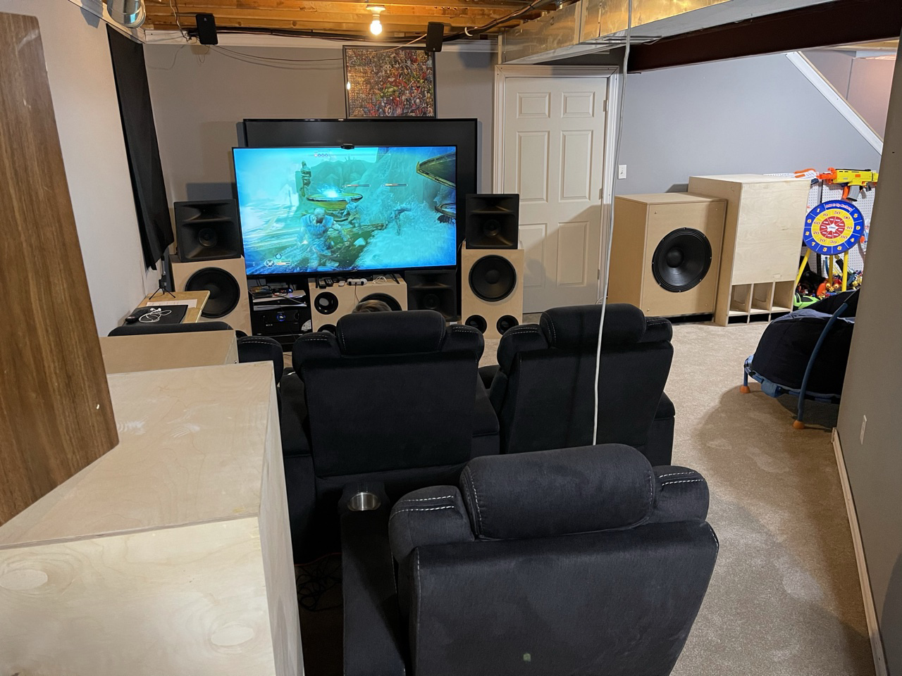

  8. Jack, I have a similar space in my basement, so we both must be in a similar phase of our home theater build. Three 1099's and four Volt 10's are do to arrive today or tomorrow, so things are really getting cramped! Please continue to post pictures as your build progresses.
    Jack H Toepfer likes this.

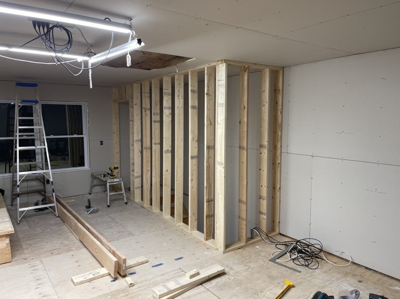

  9. Had to get the seating riser and soundstage built before I could put this wall up or getting the material in would have been a pain. Making progress on the theater while enjoying the basement... can’t beat that!

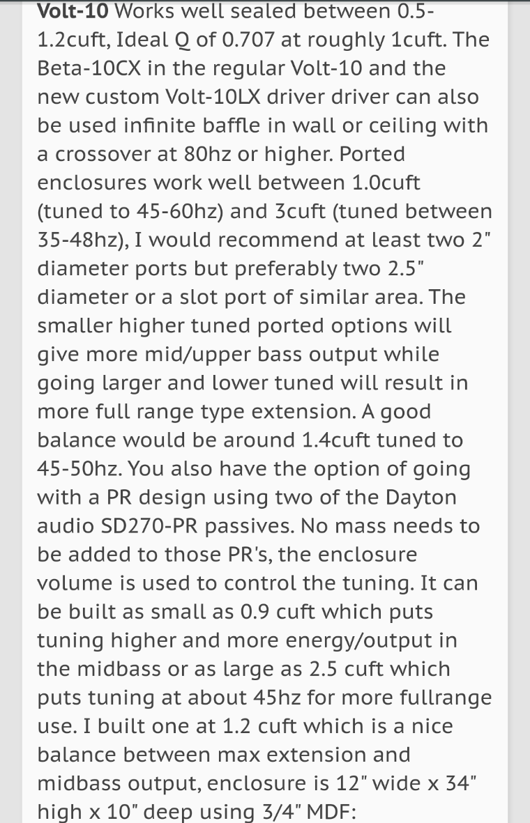

    Anyone have any plans for a ported volt 10? My set is in the angled flat pack, but I'd like to build a ported box for them. They're on music duty in my gym now. Ideally I'd like to fit them between the studs in my unfinished basement gym. (about 14.5"W) I don't have the skill to design my own.
  21. Have you considered the version with dual passive radiators on the first page?
  22. A simple ported box could be 14" wide x 12" deep x 22" high. This will give you approximately 1.55cuft gross volume. Could use a single one of these 4" ports or 1" high full width slot port that is 4" long. This will tune the box to ~50-55hz with an F3 at roughly the same range.
