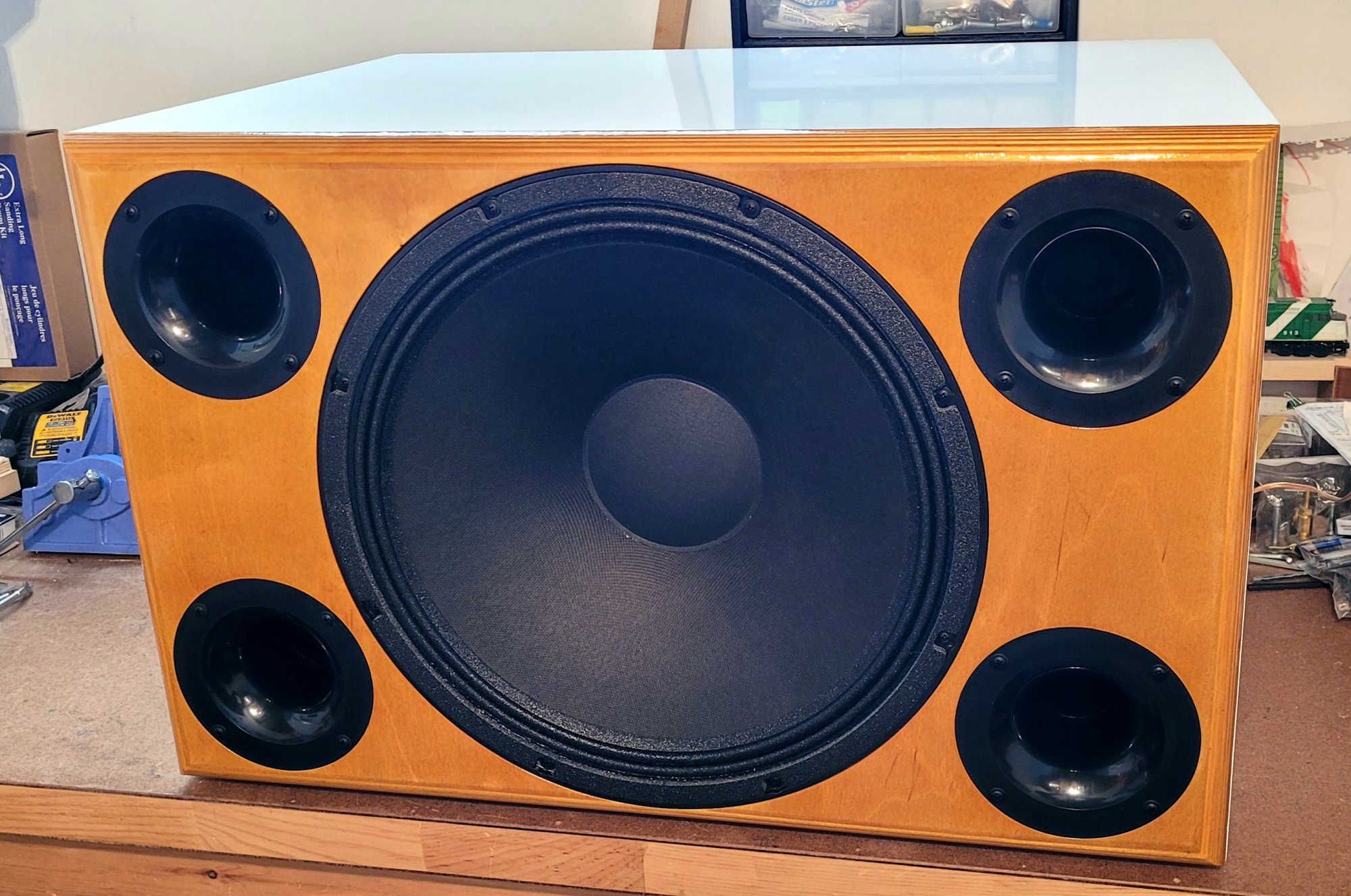

  6. Finally finished my first Vortex-15! This is a simple ported enclosure of 3.5 ft^3 tuned to 38 Hz, destined for center channel duty.
    It sounds absolutely fantastic; balanced and dynamic, with that authoritative presence that seems to come with large woofers even at low levels. I love how the timbre doesn't change appreciably going from sitting to standing, and walking from on-axis to well off-axis. These impressions are just from test listening in mono on the workbench.
    Thank you @Matt Grant and @Erich H ! I'm even more eager now to get the left and right speakers built.

  7. That looks like a nice build. I would love to hear the Vortex-15s and compare to the -12s, which I absolutely love.
