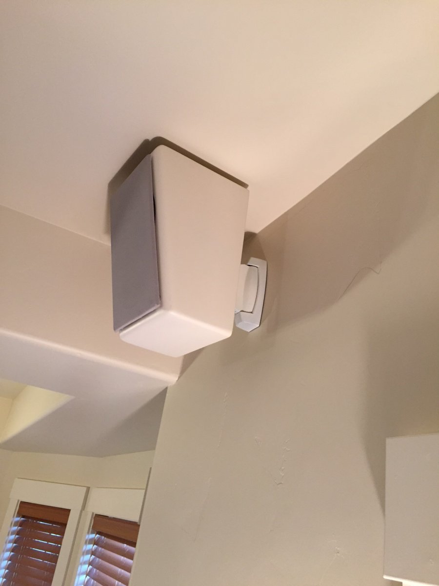

  1. The only option I can see right now, is keyhole brackets from Home Depot or whatever. I want to screw into a stud, and I want the speaker to stay flush to the wall. Simple job, but I'm sure one of you has a cool method.

    Nice! Did you spray them or they came in white?
    How did you do your grill covers?
  3. Thanks, sugarbear. I used a rattle can on the brackets. The grills were made with 5mm Luan from Home Depot (6 bucks) I stuck the fabric on with a hot glue gun. Those round overs don't leave you much room, but good enough for where they are mounted.
