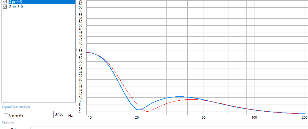

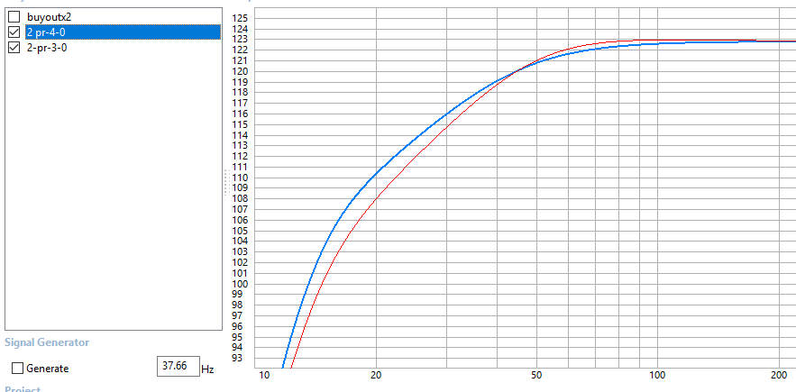

    I have two of the buyout 15's and thinking of pairing them up with a single Dayton Audio RSS460-PR 18". I modeled everything up in 3 cuft and 4 cuft enclosures. The results look good but not sure I am missing anything.
  23. Matt Grant
    837
    Make sure to look at the passive radiator excursion levels as well so you don't exceed its limits as the power level you will be driving them with.
    Certainly looks like you have quite a bit of roll off in the design as well, more then 10dB down by 20hz. It seems like it would benefit from more volume (I'd be looking for 3-4cuft per driver) but that may drop your PR tuning too low unless your current models have mass added to that PR.

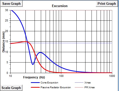

    I've the buyout 15" driver as well that i plan on using with 2 15" dayton reference passives in a 3 cu ft box. Using jeff bagby's spreadsheet, i get the following:
    This is using all 7 of the supplied washers(75g each) on each of the 2 passives:
    And this is the excursion. I will be enabling a HPF at 22Hz to safeguard the driver.
    Just need a design check before i start cutting ply.
  25. Matt Grant
    837
    I think that looks good.
