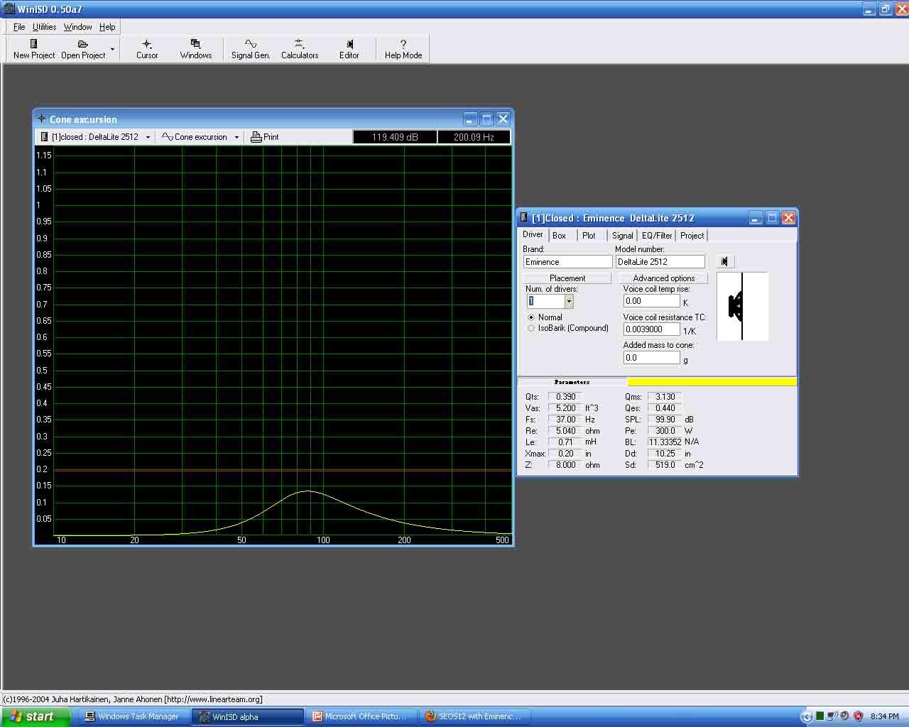

    If anyone has already done this Help! :) I'm modeling the 2512 in unibox and am hitting xmax at 47watts in a 1.9 ft3 cabinet sealed? I was planning on building about a 2.3 ft3 box sealed. Does this sound right or did I input something incorrect.
  19. Matt Grant
    843
    I see about the same in winisd. If you have a highpass at 80hz you safe until you get well over 200 watts.
  20. GranteedEV
    GranteedEV Just joined the party
    Jun 10, 2012
    44
    Your model is perfectl fine. Remember that 47 watts may not sound like much, but the woofer is 96db @ 1W so SPL is high!
    Now consider a 4th order crossover at 80hz. That is, a 2nd order butterworth highpass for a composite 4th order slope. Power handling changes to 70W before xmax, which at 80hz equates to 108db. A 4th order crossover expects the woofer to be in total phase with the midwoofer - which is means that a 108db sub and 108db mid sum to 114db @ 80hz. That is ridiculously loud - and on only 70 watts!!!! And meanwhile at 200hz and above, max SPL of the woofer alone is 115db on only 70 watts.
    Is woofer's <3mm xmax slightly on the small side? Sure, but at that price and efficiency it's to be expected! Let a sub worry about the xmax part. For reference in order for most 15" subwoofers to keep up in SPL, they will need anywhere from around 300 to 500 watts!

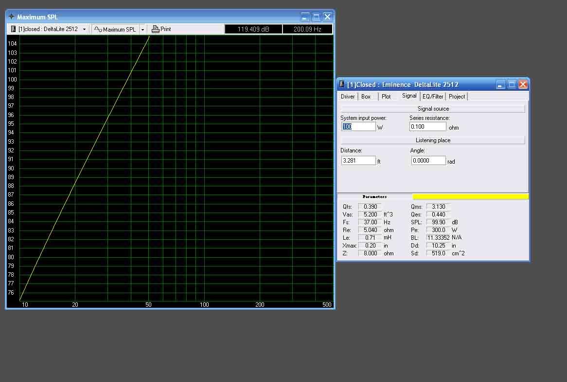

    Here's the cone excursion and SPL plots for 2512 deltalite 2 in a 2.27 ft3 pushing only 100 watts, very impressive.

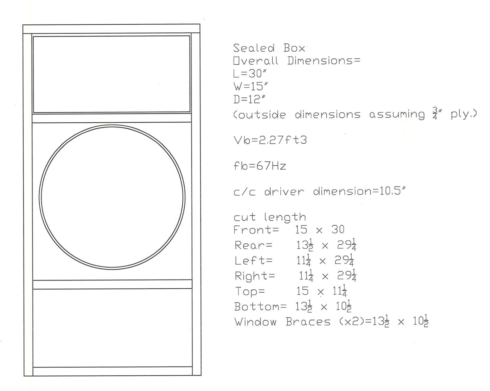

    Okay, so here is the plan. I'll let the pictures speak for themselves as they do a better job. I'll be using the Eminence 2512/DNA 360/SEOS-12. As parts start coming in I'll start posting more pics of the build. Thanks to Bill for his up front work on the x-over to make this a possibility. As of now I plan on using 2 braces but the bottom brace will probably be about an inch lower than shown so I can set the crossovers on the braces and still clear the woofers. I've also went back and forth on what material to use for damping. I've read that regular fiberglass insulation works good in sealed boxes but I've used the below with good results in the past http://www.amazon.com/Roxul-Acoustical-Batts-Mineral-2-inch/dp/B006FX8ASA
    Any thoughts or suggestions will be greatly appreciated.
