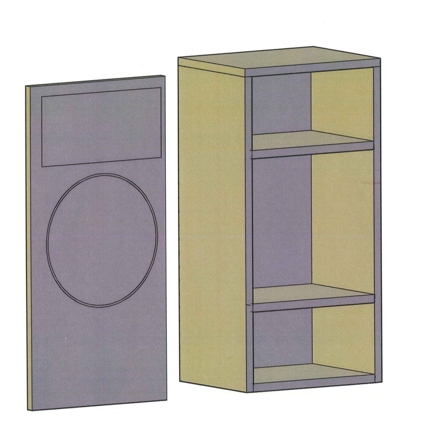

    Side and front removed view.

    On another note I've been rethinking the window bracing now I'm just considering 1" Oak dowel across the front/rear and left/right panels instead.

    I did the dowel thing for my 1st box and window bracing for 2-3. Window bracing is easier and more stable. Maybe it's just me, but I could never get the dowel lengths just right. The window is basically another top/bottom panel with windows cut out with a jigsaw: http://www.avsforum.com/t/1417294/seos12-2512-build/180#post_22300477

    Hmm, I thought the dowel way would be easier than doing all that jigsaw cutting , but thanks for your insight.I won't start building the boxes until next weekend so I'll prolly change my mind 6 times before then.

    Your mileage may vary. I ended up cutting the dowels by hand, which was probably part of my problem. But I guess my biggest learning was that window bracing was very easy to build and offer a lot more contact area for more bracing. A side benefit was that the window bracing offered a nice shelf for the insulation below the waveguide.

    I got started on them this weekend , and window bracing it is! I also plan to add a brace down the back/center between the two windows and tie the side walls to the vertical brace...Overkill,yeah probably :)
